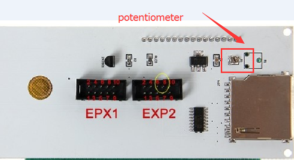

Additionally,about the 2 rows of black squares,you can try adjusting the potentiometer on the back of the LCD and you can solve it.
Look this picture:

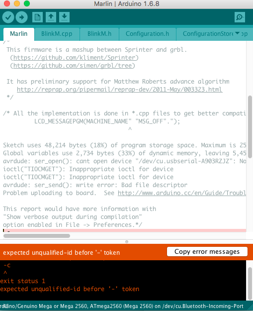

Rerun marlin gives same response as before. I have a screenshot
I have tried reloading the drivers.

here are screenshots of the results of the attempts to upload.
I have followed the advice and downloaded the driver again, but no change.
I already have that board selected.
- Screen Shot 2016-07-19 at 11.51.28.png (85.59 KiB) Viewed 12388 times
- Screen Shot 2016-07-19 at 10.38.46.png (32.75 KiB) Viewed 12388 times

Check all the steps again plz:
1.About FTDI USB Serial Driver on Mac,refer to this link:
http://www.geeetech.com/forum/viewtopic ... 952#p27952
2.About the compiling error,i think you can use an old version of Arduino(yours is version 1.6.8,the latest version has too many problems.),version 1.0.1 recommanded,download it from here:
http://www.geeetech.com/wiki/index.php/ ... or_Mac.zip
3.About Setting up Mega2560 on a Mac,you can refer to someone's experience with a Sanguinololu board:
http://dcgtek.blogspot.fi/2013/04/setti ... n-mac.html
The only thing you need to change is to select Mega2560 when you're making a choice to the "Board".
Try it patiently please.If all the above have been done and it doesn't work.Try a WINDOWS computer,i think...
Good Luck
