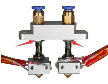

"The second extruder is seen slightly lower than the first extruder",have you leveled the hotend before you
level the bed? You can adjust the M6 nut to adjust the hight of the hotend.Look the following pic:

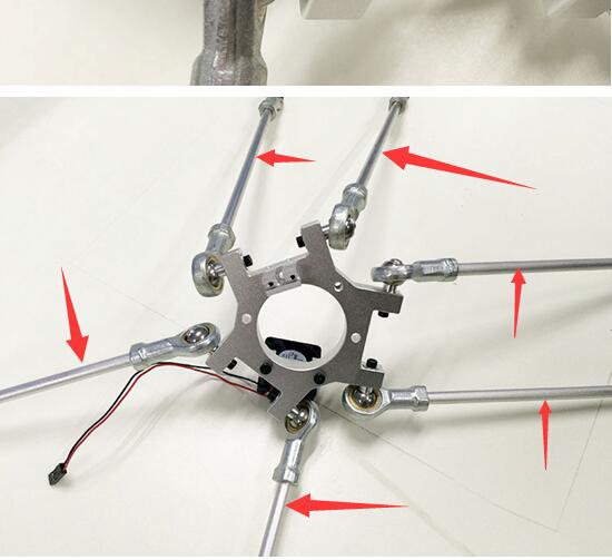

I am fairly sure it is because the arms are different lengths. I was very disappointed with the quality of the parts in the kit, I had to modify several of the parts to make them fit. The arms in particular .....I tried to correct this by crimping the 5 of the aluminum rods to make them as long as the longest. This helped a little but the problem is still affecting the machine.
Aaron
Re: Delta printer spider not level
aaron wrote:Hi
Aaron
You mean the 6 rods in the picture?How is the difference?What the respective sizes are they?Besides,you said it's the spider problem before,but now you say its the arms...So what is it actully?
