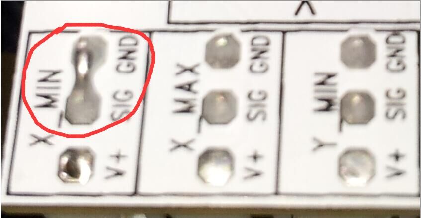

1.Did you still have the problem "endstops hit:Y" after you modified the firmware?
2.Looks like the endstop of Y_min was not triggered,you can manually trigger the endstop of Y axis if it cannot home itself when you press "home".
3.Check all the connection to Y_min port.
4.Check if there is a solder problem like the picture shows on the back of the mainboard:

Revisé lo que me dijiste y le saqué una foto, no creo que sea esto.
https://flic.kr/p/Ka5Qdu
