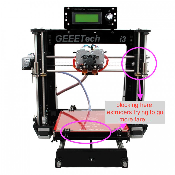

I finished to build my prusa i3 pro C, dual extruder, but i have severals problems
First and most important, is , i think, a calibration problem.
When i use the software Repeater-Host, and put axes into Home Position, i have 2 problems:
- Z axies try to go down to much, touch the bed, and almost break the glass. I have to do an emergency stop to avoid that. I also cause a lot of noise, because of motors beeing block
- X axies goes to much on the right (the side withtout the "end break sensor") So it tries to go a lot on the right, which cause it to block, and motor to make an awfull noise...
I tryed to change to positions of the Home Axies in the software repeater, it doesn't work or change anything. S
ame thing when try to change the printing dimensions, nothing change ;(
If anyone have an idea how to fix those problems
Thanks

- extruder try to go on positions it shouldn't
- prusa i3 pro C.jpg (88.37 KiB) Viewed 15216 times

1.Z axis-Have you level the heatbed?According to what you said,i think the heatbed is too high,you should adjust it by the 4 wing nuts beneath the bed.
2.X axis-You mean the X axis went to right when you "Auto Home"??Did the X-axis have a wrong direction?It should be on the left when you home...

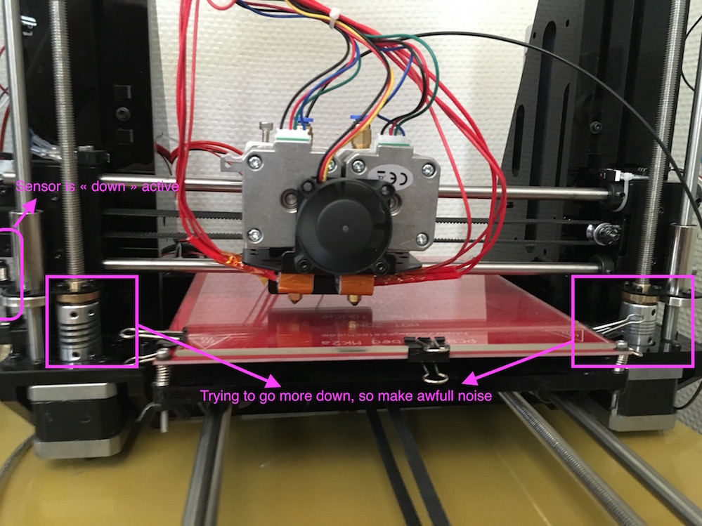

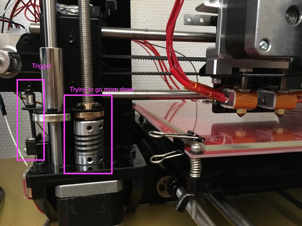

1) For the Z-Axies, here is a picture. Like asked, i have change the level on the bed by hte 4 wings nuts benath the bed. Now the extruders are not touching it anymore!! Good!! BUT it not solved yet. Like you can see in picture, the extruders are at the max bottom level, the end stop is "active", but the motors are still trying to go more down, which caused an awfull noise.
I have put 2 pictures so you can see.
Question: how fare the extruders must be from the bed? How many mm/cm?
2) For the X acies, yet it goes on the wrong side ;( How can i change the side? I have tryed to "reverse the x axies" on the repeatier software, but it doesn't change where the X axies goes home. (still going right instead of left). How do i change that?
Thanks for your help.

- Z axies problem - more detailed picture
- ZaxiesProblem2.jpg (201.2 KiB) Viewed 15205 times
- Z axies problem - Z endstop triggered, and motors try to go more down, but it's already down at maximum
- ZaxiesProblem.jpg (211.49 KiB) Viewed 15205 times

1)In my opinion,you can adjust the two objects(the trigger and the couplings) to go up a little.Then the next step is to check the connection of Z-min(the trigger),i guess it is not triggered successfully.. 2)About changing the wrong direction of X motor,you can modify it in the firmware,the following article would help you:

I think it's because your z axis endstop is not detected by the board, you can check your endstop according to the link:lezabour wrote:Thanks for your answer.

Yes!! this was it!!
I have inverted the Z and Y end stop on the board!!
Thanks for help
Did you manage to see the video i sent you? If not, can you tell me how to send you a video? Cause on it, you can see the noise that make the Z axies while moving (not when block, but when regularely moving)
I think it need lubricant, or their is a problem with the positions of motors and rodes axes
