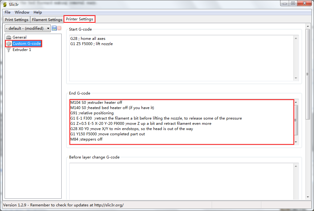

I'm on M201 1.0.5 and one nice feature I've noticed (not sure if it was there before or not) is that once the print is finished, it sets the temperatures to 0, ejects the filament, and sends the nozzle to home.
This is great except that because it seems to do a simple XYZ home straight away, it often drags the hot nozzle through the top of the print leaving a big mark.
In my opinion it should:
1) Move up at least a couple of mm in Z
2) Do an XY home
3) Only once XY is homed, do a Z home
If there's a setting somewhere to change this behaviour, please let me know. Thank you.

You can find this setting in the slicer,and add some custom codes to avoid that.
