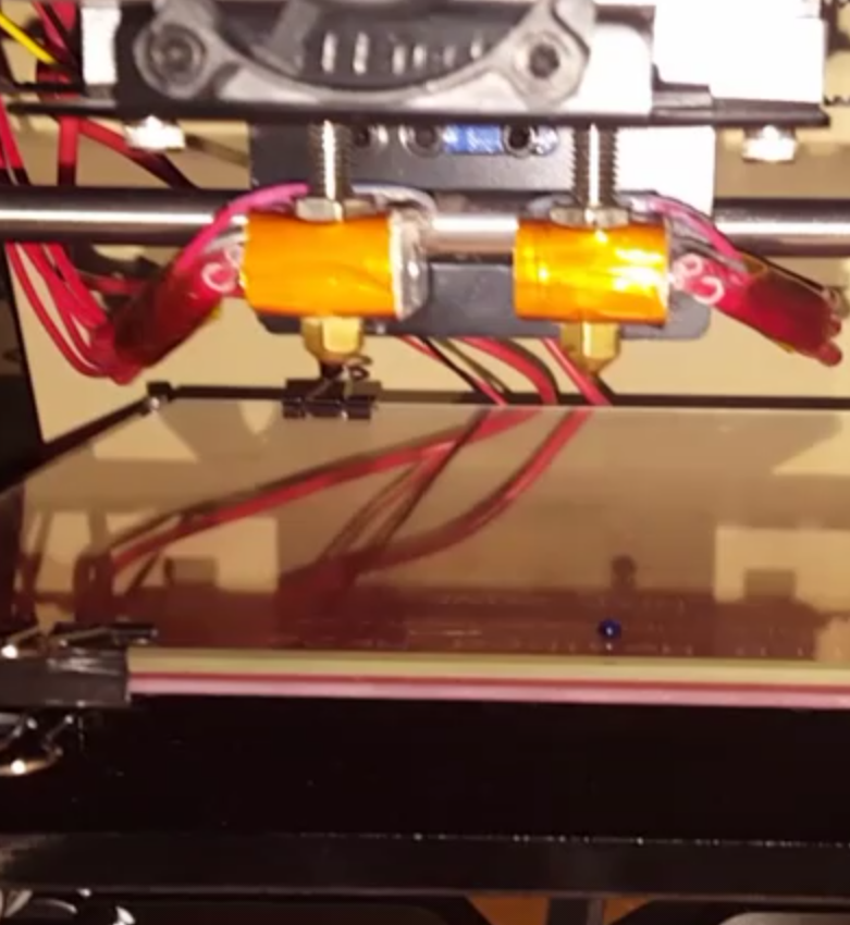

Sorry for the confusion, I mean that it prints at the very edge of the bed so it cant move any further in the y direction. All my end stops are set in the printer settings to 0. Is that what you mean by their status? When I send the m119 command to the printer it will register them as triggered or open depending on if they are triggered or open so they are working correctly. The video isnt attaching but here is a picture of where it is printing at. Note that in the software the part is placed in the center of the bed but once the code is compiled and actually starts printing the y axis isnt printing in the center of its travel. So my y axis print area is 200mm and I tell it to print at 100,100 (dead center) it seems to be printing at 100,0.
