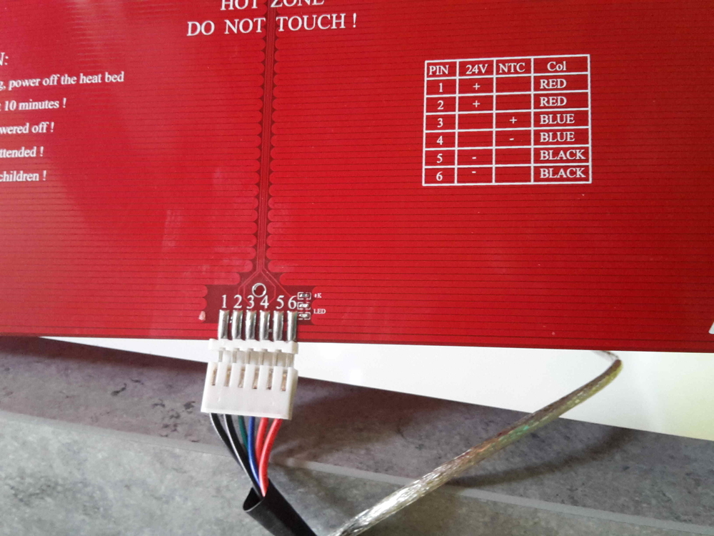

Hi
Have just built my Prusa I3 M201 and can not get the bed to heat up.On the bed I have has 6 solder lines 1&2 Red 3&4 Blue 5&6 Black but the connector I got there is no way the 1&2 can be red as the connector will not fit on that way. I have put it on the other way bed not heating up. Have I blown something?
Thanks in advance for any help.

organic wrote:Hi
Could you please show me with a video?Thanks

Did you check other problems that cause not heating up?Cuz as far as i know,the red wires and the black ones don't effect the heating,though they are in opposite position...You can check the following problems:
http://www.geeetech.com/forum/viewtopic ... 19&t=17039

The bit on that link where it said For GTM32, measure the voltage between the pin1 and any of the other pins(GND), when heated up it is 0V and when not it is 24V I am not getting 1.7 v
