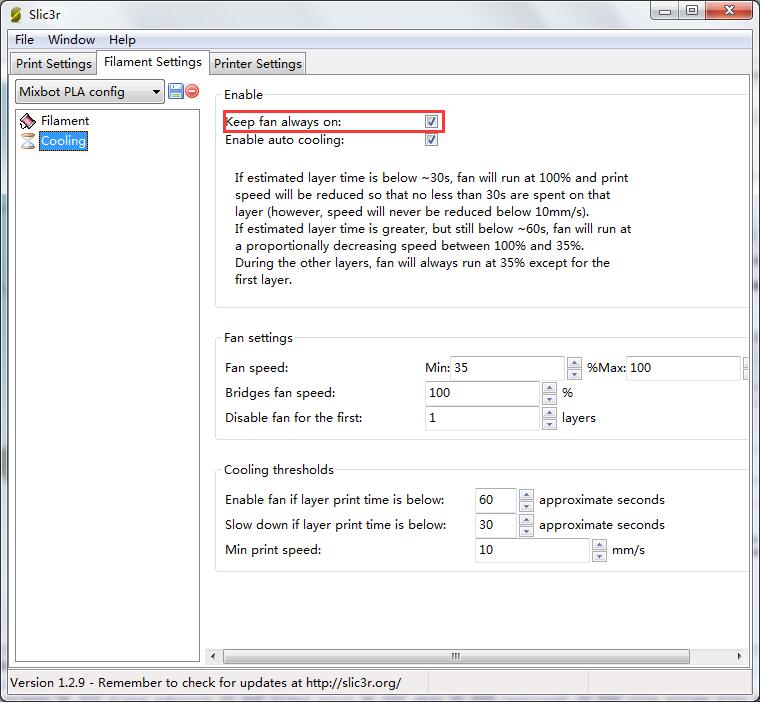

Have you enabled this setting?

I have tried with all cooling disabled and it doesn't sewn to change anything, the fan comes on as soon as the power is switched on.
I've tried sending the M106 S0 command manually from Octoprint and all it does is slow the fan down, it doesn't actually stop it.
