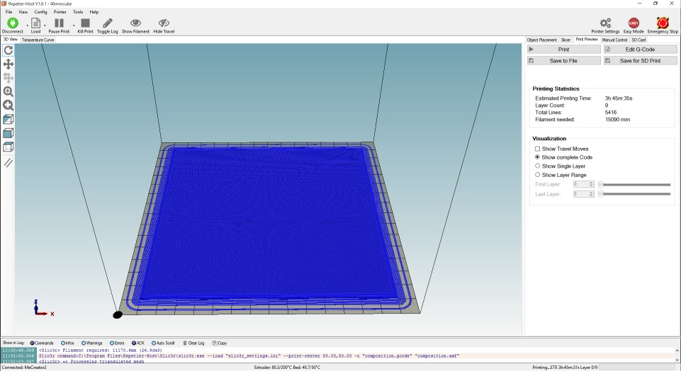

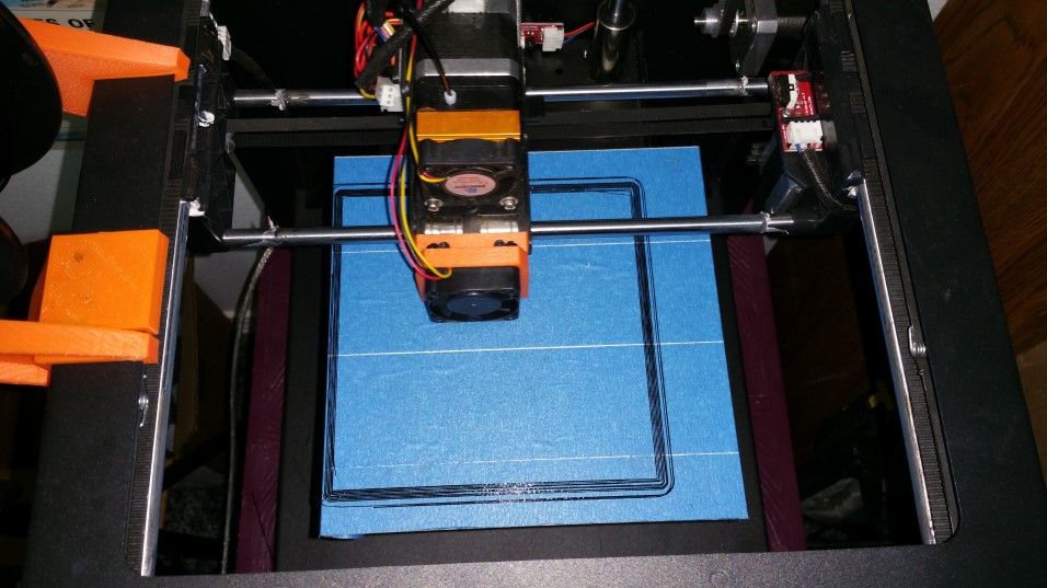

Like John, I am also having issues with my printer not printing in the center of the bed. I did try what John suggested, but the print head would just stick in the back right corner and would not move at all. I both manually moved my carriage to the front left and used the jog dial. I would really like a resolution to this issue soon because it is making me crazy. I have attached a screen shot of my slicer showing where the model should be printed, and an image of my printer showing where the actually print is happening.
This is where it should be printing.
This is where it is actually printing.
