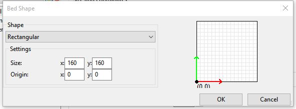

Like John, I am also having issues with my printer not printing in the center of the bed. I did try what John suggested, but the print head would just stick in the back right corner and would not move at all. I both manually moved my carriage to the front left and used the jog dial. I would really like a resolution to this issue soon because it is making me crazy. I have attached a screen shot of my slicer showing where the model should be printed, and an image of my printer showing where the actually print is happening.

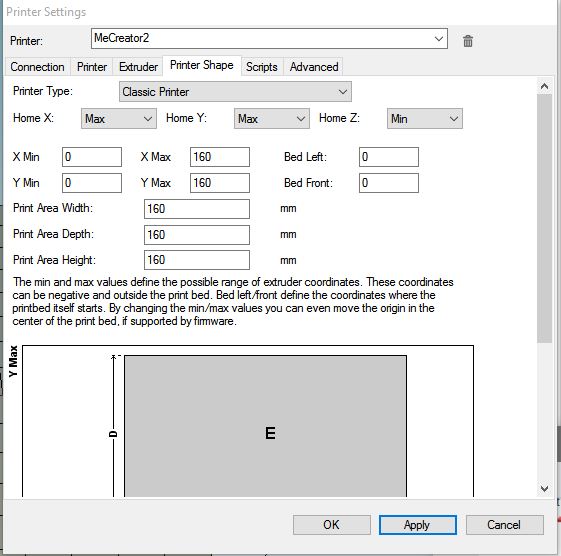

2.Not In The Center Of Heat Bed
Not printing in the center of the bed,there are two possibilities:
1)Did you have a right setting in Printer Settings?
(68.23 KiB) Not downloaded yet
2)Was the size of the actual printing the same as the size of your model?If it wasn't, maybe the step/mm of your motor is wrong.
I have verified the dimensional accuracy with my printer, and it is correct.
Here are my bed settings in my slicer:
