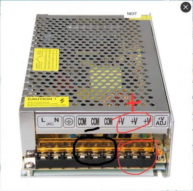

You can measure the DC output(between +V and COM) of the PSU with a multimeter to see if it is about 12V,maybe the PSU has broken.

OK,I think you can shoot a video before you open it to prove it has a problem itself earlier,then you can refer to my way to check the DC output.How do you think?
