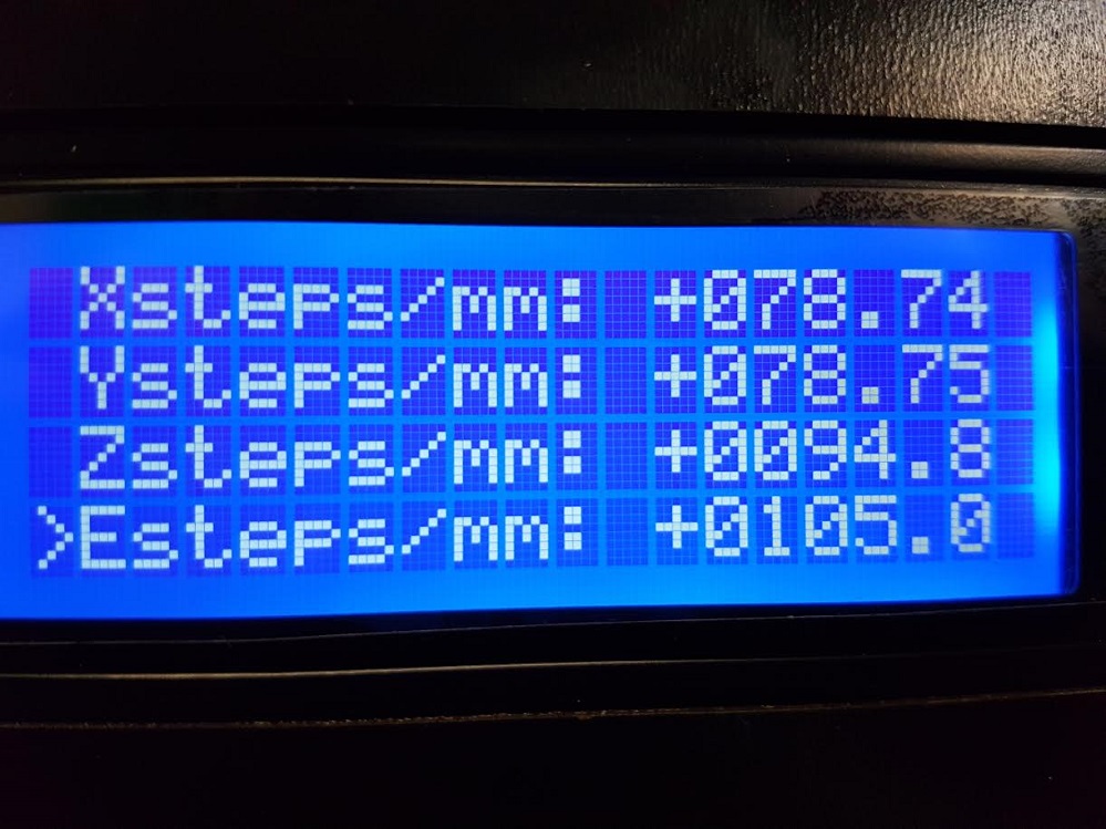

I have everything working except for the z axis. so far the only way I have managed to move it is change the value of the zsteps/mm from +2560.0 to +0094.8 this allows me to move it up and down in the move zaxis screen by either 1mm or 0.1mm.
doing this only allows me to move them does let the printer move up while printing. The printer does everything else perfectly. I can start to print something and it will do the first few layers then starts dragging the head on the plastic
If I use the default settings the steppers just scream at me and refuse to move up or down.

I have measured the pot for the z axis driver board and it is -0.09 I have tried -0.04 and -0.10 I am a bit confused as to why its -0.09 and not just 0.09?
