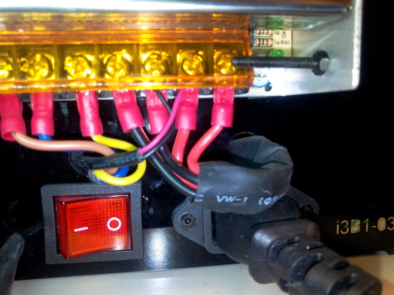

It is very easy to be electrocuted from the power unit because it is possible that the protective cover can to be open inadvertently, I solved by adding a screw as in the picture. The hole it is already present and I used advanced screws. It think that is a hint for in the assembly instructions.

I found the cover can be locked if you press it down hard.
