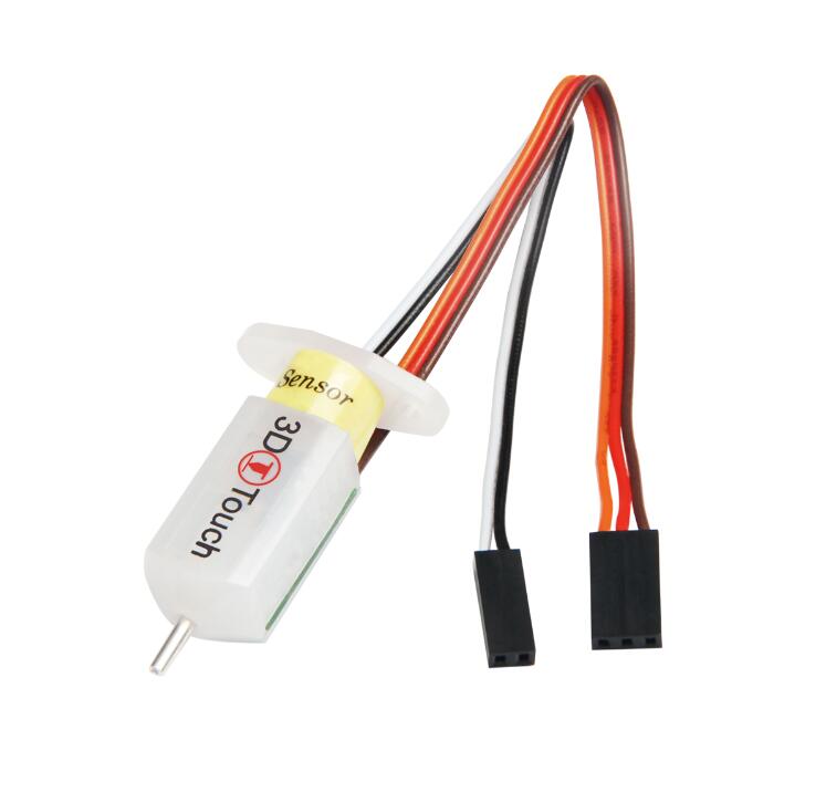

Hi, there
Tired of leveling your heat bed manually?
Would you like to add an auto-leveling system for your printer?
For me, the answer must be "YES".
Now,here comes our protagonist:3D Touch Sensor
Her chief features are:
Simple,Smart,High-precision,Innovative Solenoid: Ultra Power Saving,Technologies,wide Selection of Bed,Optimized structure: Larger Build Size
I've already add it on my printer,it is so charming and has a perfect performance on it.Here is a video about it:
https://www.youtube.com/watch?v=7aav0i5cOL4
More importantly,everyone(a newbie or experienced guy) has a easy access to the Auto-levelling world,cuz there are detailed guides(including software and hardware) in the manual.

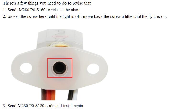

I am sorry to say, but i think my sensor i broken. It only flash red light, but it dont push pin up or down.
I updated my marlin firmware with the help of the instructions from this site http://www.geeetech.com/blog/tag/3dtouc ... ng-sensor/
i use manual codes ( M280 P0 S10 ; pushes the pin down )
But no reaction another than blinking red light?
What should i do?
Re: 3D Touch Sensor:Auto-levelling for Geeetech 3D printer
See the following picture:
