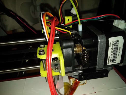

I am having the same issue. When i tried to calibrate the esteps, i saw that the filament did not move smoothly downwards. It was stopping and going. (Check this by making a mark on the filament with a pen).
I was also frustrated about the lack of tension adjustment between the driving wheel and the idle wheel.
The extruder i have is http://www.geeetech.com/new-mk8-extruder-p-998.html one ("New MK8")
I made a hacky solution to the problem by wedging something in between the tension thing.
This is not an ideal solution at all, but i have seen improvement on the extruder feeding. I also saw a smoother feeding at 220 degrees compared to 200 degrees.

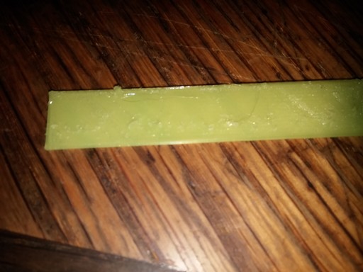

OK. Today I totally changed feed rates, etc and repeated print of a design that required small detail - using the 0.2mm nozzle. There were still problems, Basically, the feeder worked OK until there was a need for retraction. In Slic3r this was set at 3mm and 40mm retract speed. I noticed that the mark went up, back and up and back - but each up was higher than the last - that is there was no more filament feed. Experimented with these elements. Retraction, 1mm and 10mm.sec worked a treat. I ended up with, finally, a rather great output. While I still have very serious engineering doubts about the supplied feeder with no ability to adjust either the tension or cog positioning, I have been able to adapt it. In short, the originally provided filament feed system is seriously deficient in future performance. The fact that it failed my expectations less than 2 months into my 3D printing experience is symptomatic of a number of flaws with this GEETECH printer. Yes, I have spent a further $au15 in replacing this feeder mechanism - through GEETECH online store. But should I have needed to do so? AFAIC, this is essentially a warranty issue - I have paid $ for something inherently wrong that 'lived up to its failure' within 2 months.
Any hows, hopefully the pics will attach this time around.

Seems a previous reply has gone astray. To the nub - the feeder mechanism supplied with the kit has no force adjustment - just a spring. Said spring being redundant as the lever arm it presses against has an end stop. I filed this end stop to try and increase the tension. It worked, sort of. The feed rate was still HIGHLY variable. I recently had the feed rate set at 266 and still failed to achieve 100mm feed. But when I physically pushed up on the lever, the feed rate dropped back to below 130. I added a M3 washer underneath the spring - heavens above, it all started being good again. A filament feeder I had printed was weak, structurally - the whole thing wobbled and strands could be pulled away by hand. Not to mention the wasted prints now sitting in the bin - around 0.5 KG of wasted filament trying to resolve this issue. Anyhow, I knocked a simple wooden spool holder, used my half baked end cones with ball bearings inserted and the crappy filament feeder to print another filament feeder. It worked. I have now printed the spool holder I wanted (own design). I'll be mounting this on top of the LHS Z axis fixture, using longer screws to utilise the existing 2 screw holes that also attach the z axis top plate.
In short. The supplied extrusion feeder is inadequate for the job. You can modify it a bit - file away some of the structure under the V wheel bearing (remove all first), delete the heatsink (it is totally superfluous), add some 9mm spacers (3mm ID, 5mm OD from Jaycar or equivalent), place a M3 washer underneath the spring and you're away again . BUT, for how long. The supplied spring is, apparently, inadequate for the job. It fails to retain its compressive force AND it can only extend this force to the limited movement of the lever system.
Thus the reason WHY I decided to buy the 'updated' feeder mechanism version - with tension adjusting screw. Mind you, the design is still 'seat of pants'. A screw mating with a screw and another screw 'holding' the lower part of the spring? I know I'll re-engineer this thing so it looks professional and works even better.

Had the same problem with my feeder. Added some washers to adjust the tension of the spring and now it works.
Also thinking about replacing the plastic parts with the older alu version.
