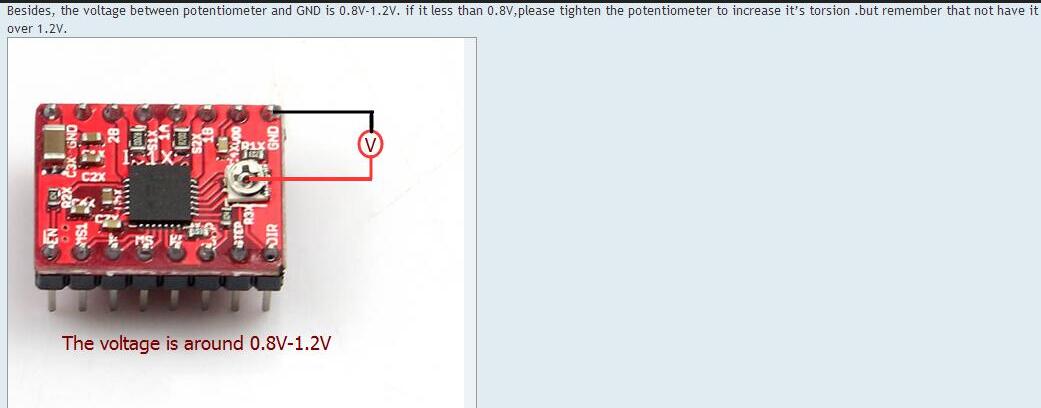

Before that,see the following picture,you can try fixing it,rotate the little screw to increase the driver voltage and measure it with a multimeter:

No way , i try this before and that no resolve my problems , i think this piece is litteraly out , never works before you send me the prusa ( It'snt your fault , you can't check every package ) . But i received prusa since one week , since one week i speak with you on ebay and on this forum and no one want send me a £#@king piece at 2€ , seriously ?? I gonna leave a bad comment , I buy you a not working machin , please send me a new piece , I just want use my machine . I'm sorry but If nothing change in a week , I am going to begin a dispute on paypal , I repeat : You send me a not working machine , I know what goes wrong with him and you don"t want change piece ... Wake up , really .
