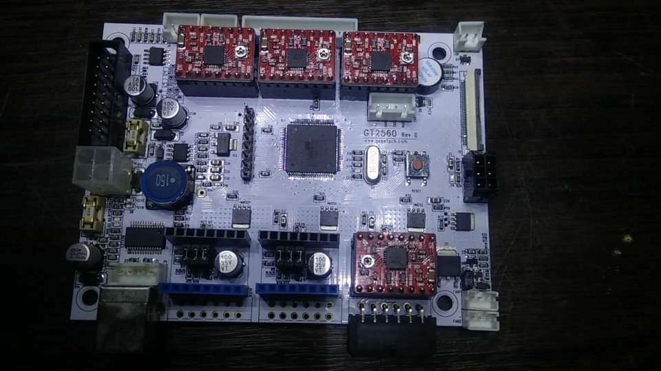

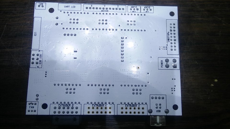

Hello!
Could anyone tell where to get the firmware files for this specific board? "GT2560 Rev B". Look at the pictures i posted. All that i have found is for some other revision, strangely also "rev B"... And also anyone else having same board?
Those files that are on the other thread to download has wrong pins specified. The files specify MeCreator 2 as an Ultimaker, which has for example these pins:

And what i measured:
Code: Select all
#define E0_STEP_PIN         38
#define E0_DIR_PIN          40
#define E0_ENABLE_PIN       25
#define E1_STEP_PIN         35
#define E1_DIR_PIN          37
#define E1_ENABLE_PIN       36
#define E2_STEP_PIN         41
#define E2_DIR_PIN          39
#define E2_ENABLE_PIN       51
And so on.. They won't match.
The purpose of why i took out the board because i want to install an diamond hot end for this.
Bottom side
Bottom side
Top side
Top side
Re: "GT2560 Rev B" firmware
The board is used for Mecreator2.So you can download the firmware for that printer.
Here it is :
http://www.geeetech.com/forum/download/file.php?id=2464
