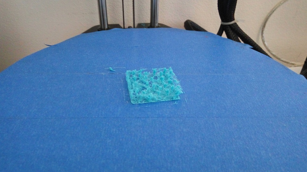

Hi.
My 301 is now correctly calibrated, but printing quality is poor.
I use PLA
Is seems that ther is not enough filament pushed by the extruder, so prints are full of holes.
The flow modifying in repetier host does not change anything.
Wher to modifie in firmware to tell extruders to push more filament ?
rostock 301 filament extrusion
- IMG_18092016_135808_HDR.jpg (174.88 KiB) Viewed 10617 times
Re: rostock 301 filament extrusion
lattest firmware.
you can change extruder steps per MM on the printer itself.
Click/select-->
-->Control (really should say Settings)
---->Motion (Stepper Motors)
------>ESteps Per mm
dial up or down to desired value
-------->Select when done
------>Select again
Scroll down
---->Select Store Memory (write to EEPROM)
I hope this helps. i recommend calibrating your steps per mm for the extruder.
I've set the Esteps/mm for Extruder3 - unfortunately the other extruders do require another setting in order to push out the same amount of filament!!?
If I have 3 settings for the 3 stepper motors XYZ, why don't I have 3 settings to address each extruder?
i didn't. unfortunately the firmware is closed source. not all the configuration parameters are presented on the LCD interface.
at the present moment this is the only way to adjust the printers settings.
there have been some efforts to replace the firmware with marlin for STM. but i am not aware of any successes yet...
the only option is that or to replace the controller board with a RUMBA board. this would be a major rewire effort due to the specialized wiring harness.
the 8-bit atmega RUMBA is under powered for Delta (Rostock) use and 3 color blending would only mate things worse so i don't recommend this.
my opinion is the printer was released before the software was ready for general use.
I would like to see at minimum more options available for configuration. i have a BLTouch just waiting to be installed on this printer.
there needs to be better access and a BLTouch/Layer fan option in software and a STL part made available to support them to make this printer more useable
