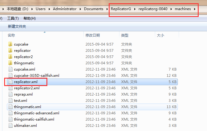

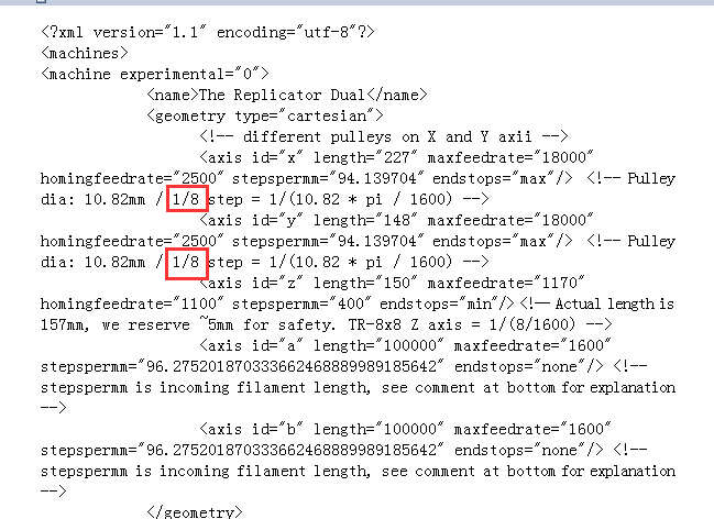

how about change the subdivision here, could this work?
