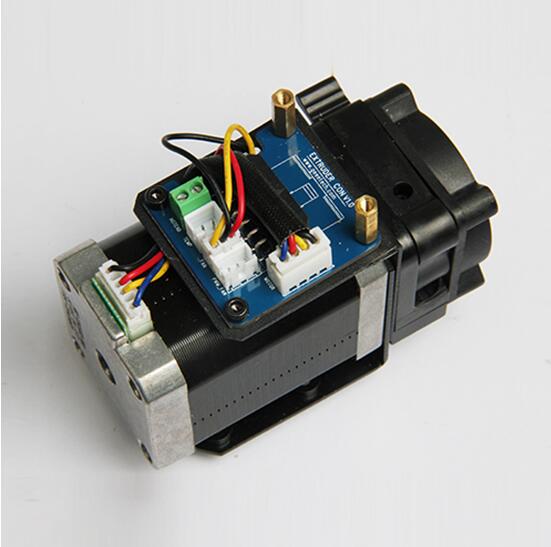

1) it states fit the heat sinks and stickers on the stepper motor driver (but where it doesnt say or I cant be sure where it could go),
2) On the 3 extruders there was three long leads that appears that they have to be removed to replace them with three very short leads that go onto the circuit board ( have i done the right thing?)

1)See the following pic,the heat sinks stick on the chip of A4988:
2)The three long leads are the fan wiring on corresponding extruder motor,which connects to the port on the blue circuit board,while the three short leads are the motor wiring,one connects to the motor socket and the other one connects to the socket on the blue circuit board,see the picture i attached:

thank you, I had found where to put the heat sinks from another forum, so that was completed
the 3 long leads I was talking about I noticed that you had them removed too, and replaced them with the 3 short leads in your photo that you posted
