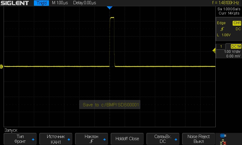

When GTM32 execute G28 command STEP pulse witdh for driver IC's is about 0.4us - this is not enought for correct work both step driver (A4988 and DRV8825).
Look attachted STEP pulse width oscillogram when GTM32 execute G28 command:
Accordingly to IC's specification:
- A4988 - min STEP pulse width must be 1 us at least
- DRV8825 - min STEP pulse width is 1.9 us

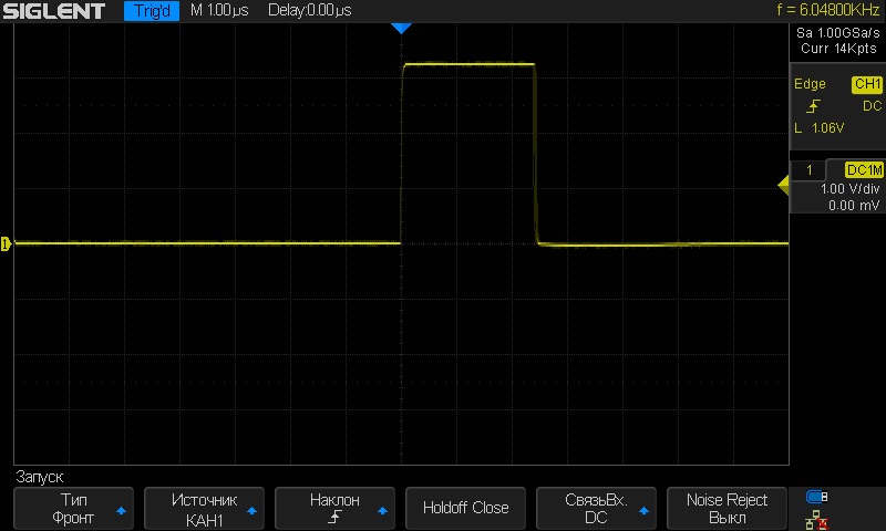

When GTM32 execute command G0/G1 or make Manual movement from main menu pulse with is about 2.4 us - this is enought for well work both driver A4988 and DRV8825
Look oscillogram when make Manual movment:
Same one for G0 and G1 command.
2.4 us time is more then specified 1us for A4988 and 1.9us for DRV8825 - as result both driver work well when exucute G0/G1 commands
