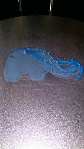

thanks , I have followed the guide , still not right no matter what I do , this is what it looks like when printing. Any suggestions ?

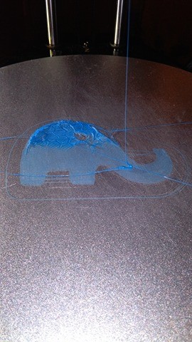

that was with the setting on the instruction guide for printer and slicer , the second picture is with the downloaded settings for the slicer in the manual.
I done the calibration as per the instructions , any ideas guys ?

Looks like you didn't level the bed perfectly...Try it again.Make sure you level all the spots on the bed mentioned in the guide.
In addition,i think you'd better add some blue tape(adhesive paper) on your heatbed,not print on the Aluminum plate directly.
