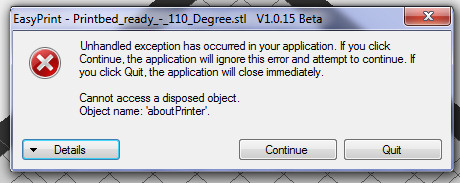

Selected Printer: G2S Pro. Selected Printer Information. Got Exception.
This was on a Windows 7 PC that did not have a printer attached to it, but the exception should be handled quietly.
I have the details of the exception, but .txt files are not accepted as attachments. Let me know if you want it, and I'll send it on after I get back from vacation.

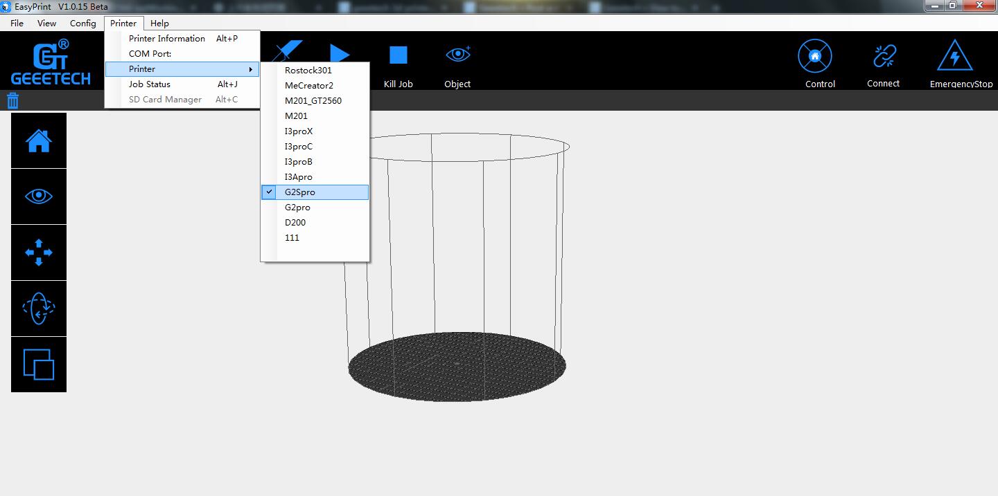

Re: First impressions
I'd appreciate it if you could offer the ".txt files" about the errors.
As for the Baud Rate for G2s is 250000 indeed,and mine is normal about the bed shape and the printable height.Look the following pic,maybe you forgot this "Printer->printer->G2sPro"?
