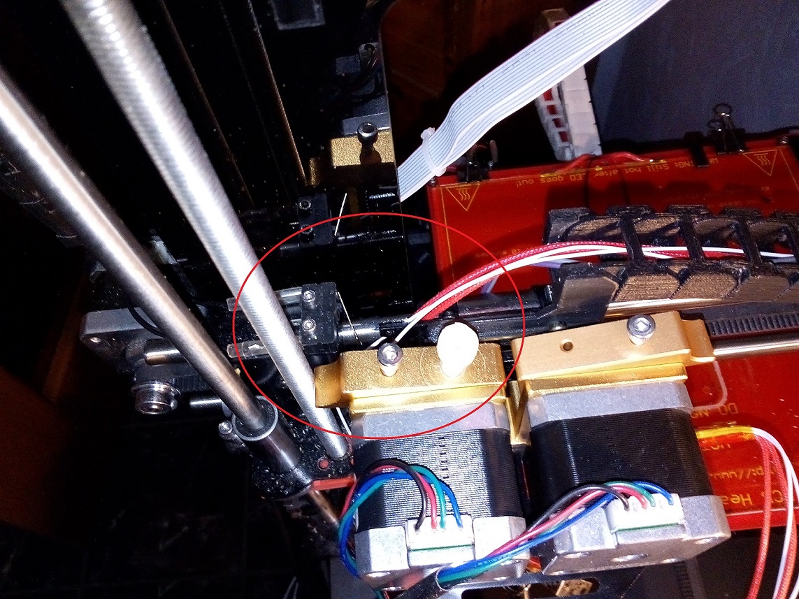

Hello,
i bought for my Prusa M201 a Mk8 Dual Extruder, I also bought the Geeetech Mk8 Dual Extruder holder
i have a few questions and problems.
1. I cant reach the x-end stop now. The extruder hits the z-rod first.
2. The nozzle is higher than the x-axis holder where the bearings are.
3. It is tricky to get the cable for the heatings in the right direction. Left extruder to the left, right to the right. The nozzle must be thight, but the cable is always not there where it should be.

Hello,
I have the same problem !
Does anyone have a solution?
Thanks for help !

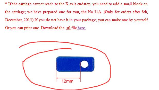

A photo !
Re: Mk8 Extruder on Geeetech M201 printer
Didn't you have this item in your package?
If you have no one,you can print it yourself,here is the stl file:
http://www.geeetech.com/wiki/images/d/d ... rigger.zip
