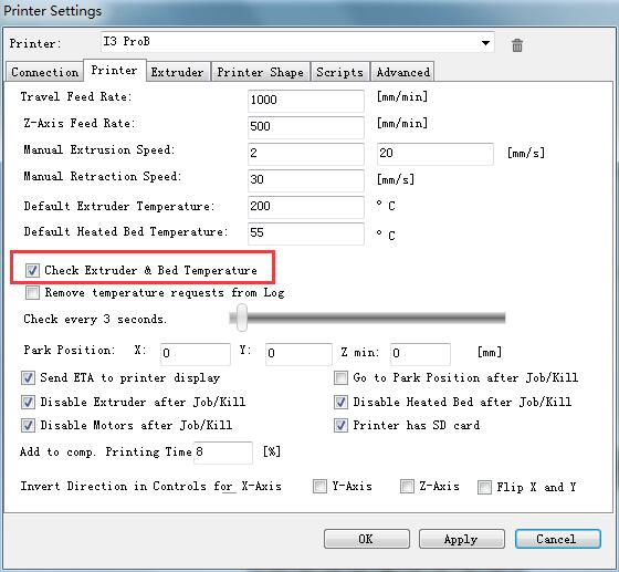

Did you have the same results when pinting with SD card or USB connection?
You can try unchecking this option to see how it works:
