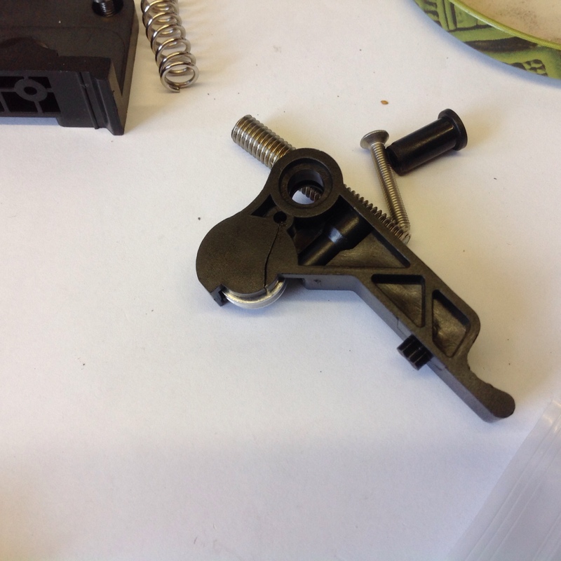

I have the Acrylic I3 Pro B with the plastic MK8 extruder, just assembled this week.
I have had endless issues try to calibrate the extruder flow, sometimes it works but most of the time the filament pull is very inconsistent.
On inspection of the MK8 inner workings today I found what could potentially be the issue, the metal roller that provides pressure to the stepper gear is actually on a plastic shaft and that shaft is crumbling and falling apart.
Ridiculous I know, absolutely no precision in this plastic MK8. I have ordered the metal variant which will hopefully solve my issues. https://www.geeetech.com/mk8-extruder-a ... p-995.html

Re: Extruder not working
I had the same problem and bought a aluminum one. Just received the part. Hope that will resolve the problem.
