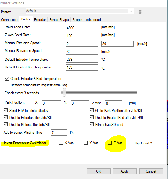

are your z motors plugged into the correct slots and have you tried reversing the z direction ?? i.e.maybe up command is sending the motors down.
so command the motor to go DOWN and see if it goes up.
Repetier has this setting - try inverting the z direction>>>
