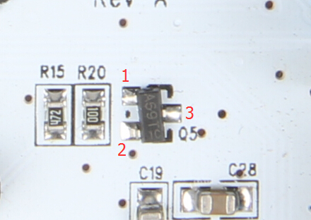

If not, at least, tell me what is Q5 on the board? What is nominal or substitute of Q5? Why do i need to know? Because, mine burnout. This is what happen. I was printing big thing, 5 hours print on my G2S. Hotend cooling fan went out first. Replacing cooling fan didn't help, new fan didn't work. After visual examining of GT2560 board I discover that Q5 looks different. Everything is working except hotend cooling fan.

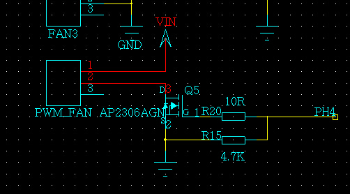

the Q5 is the one here:
name specific type
mosfet SOT-23 AP2306AGN
And you can remove the Q5, short the pin2(GND) and pin3(PWM FAN) using the soldering iron, then you'll make it work too:

Thank you Mark for reply. The schematics diagram: http://www.geeetech.com/forum/download/file.php?id=532

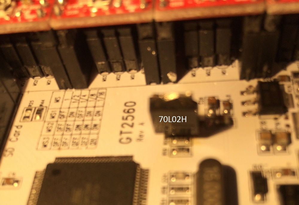

I find that 70L02H http://www.datasheetbay.com/datasheets/ ... 0L02H.html transistor is a good, "direct" replacement. You can salvage one from old PC mobo. Yes, It's bigger, but has more power, 66A at 25v. You have to mount it vertically
Q5 replacement, Mount of 70L02H transistor on GT2560 board
No radiator needed, don't have to change any of resistors on GT2560 board. It Will give you full range of PWM from 0v to 12v or 0v to 24v (if you use 24v power supply) at 66A. After involuntary upgrade, I can use it (fan control software) to control burning Laser or any device which require high power output.
