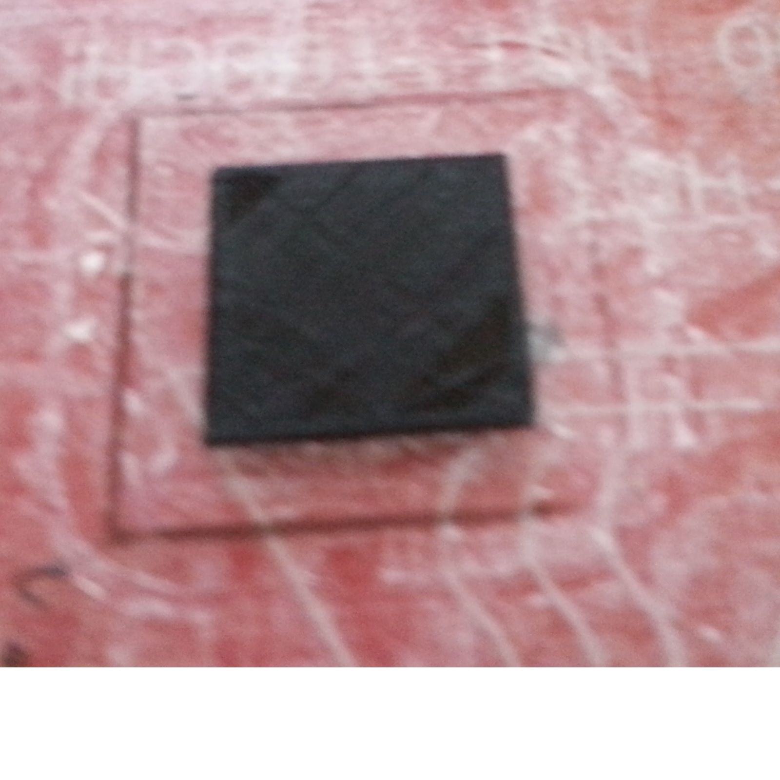

hi again been busy so today i check the PSU and it gives 12v even when the retraction..
i also try to print the cube test you send me the link of...... and at 15% about 4 minutes it did it again it retract the filament
i add a pic hope you can see where it stopped
thank you in advance for your respond
- this is where it gets and then the retraction begin..
- 16oo.jpg (342.27 KiB) Viewed 14055 times

[quote="stavros_gr"]hi again been busy so today i check the PSU and it gives 12v even when the retraction..
after the retract i did an auto home but it not lose the point where it stopped(hope you understand what i mean ....)
