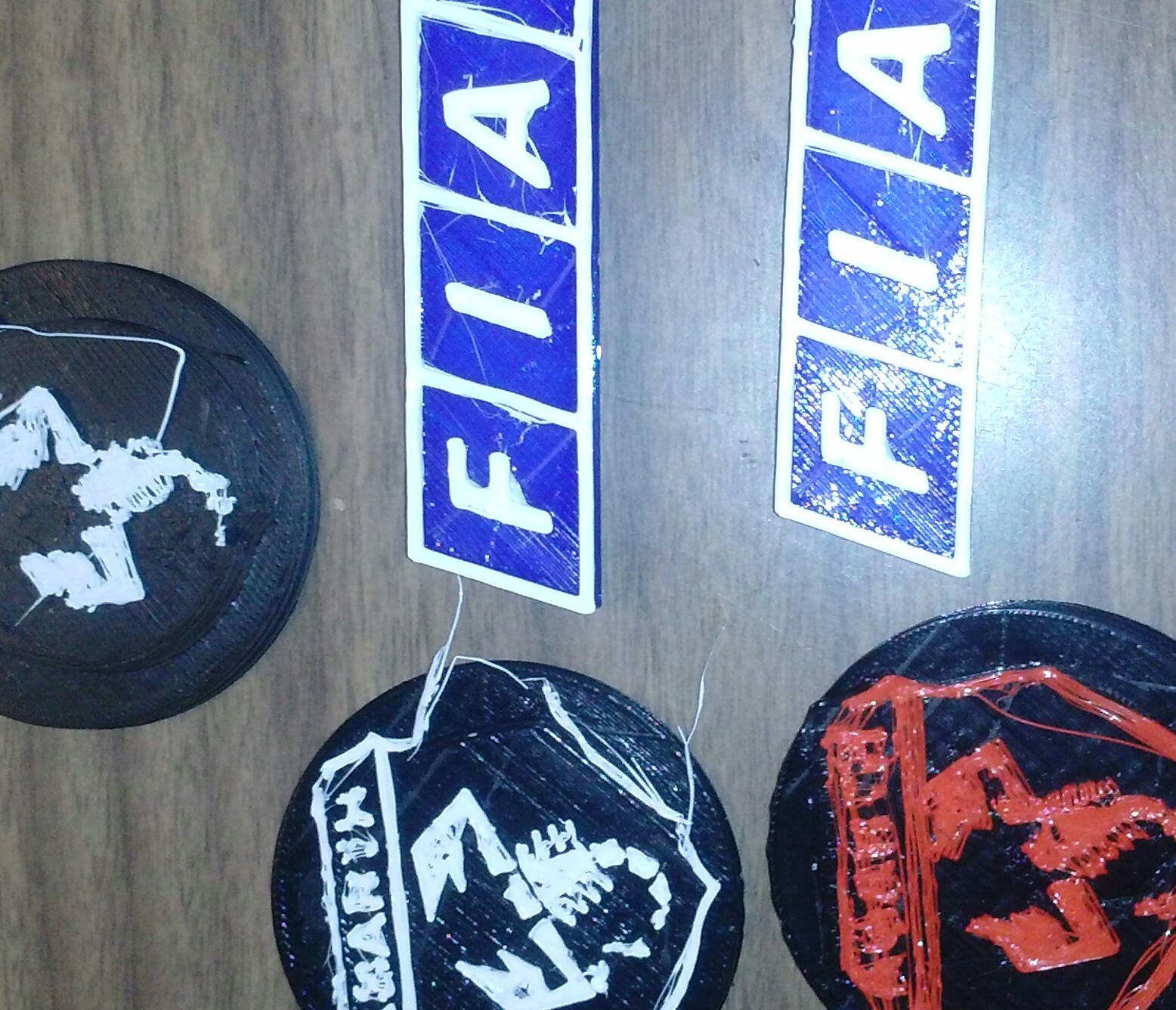

I have printed a few logos: FIAT, FIAT Abarth and Oakland Raiders. All three of them have trouble when i switch to white as second color. ABS doesn't do very well at all. PLA sticks better but I don't get a good first or second layer. I use this bit of G-code to switch filaments:

Any ideas how I can make the second color work better?

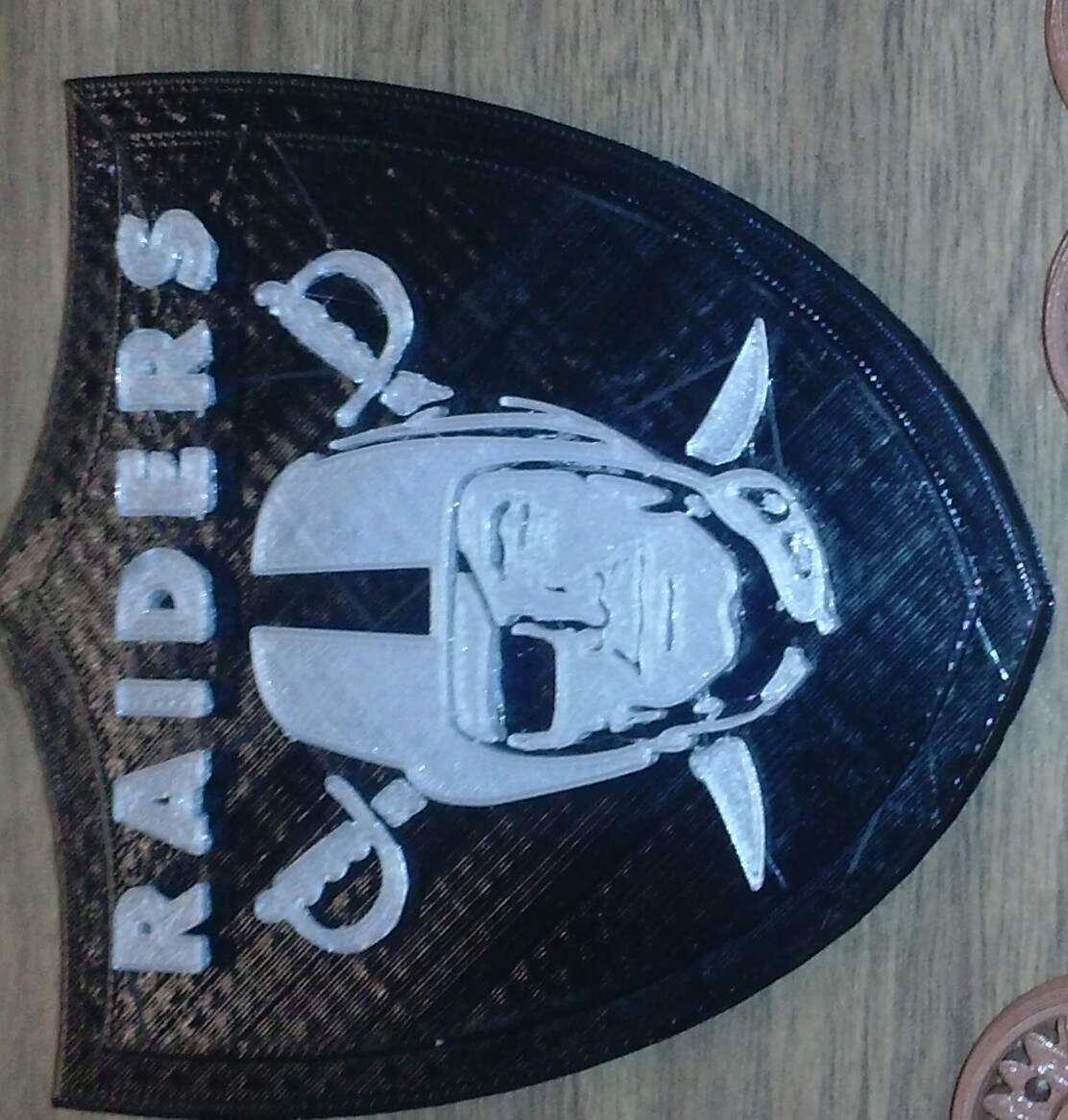

Raiders was all PLA
Raiders was all PLA
Raiders logo.jpg (267.56 KiB) Viewed 4938 times
Only the worts Abarth hub was ABS. The other 4 prints were PLA.
