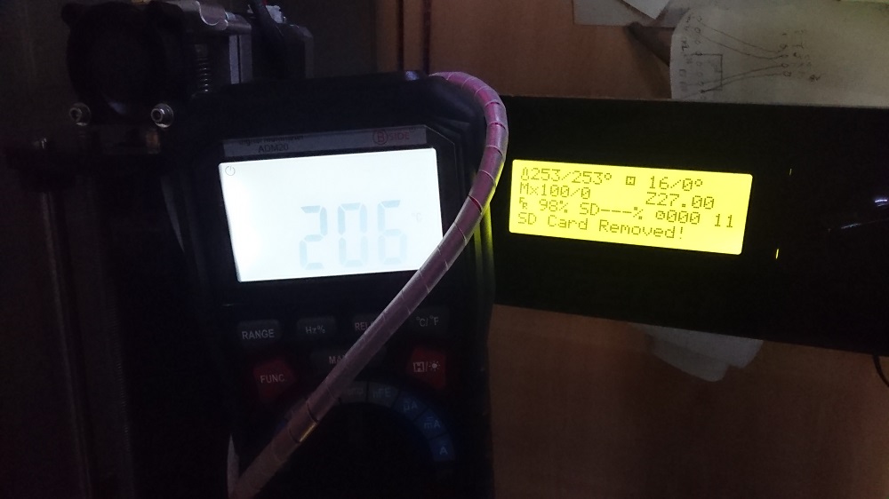

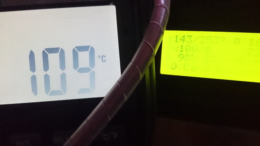

Temperature what printer use is not rigth (pic. 1,2,3,4) and Ican't adjust it can I.

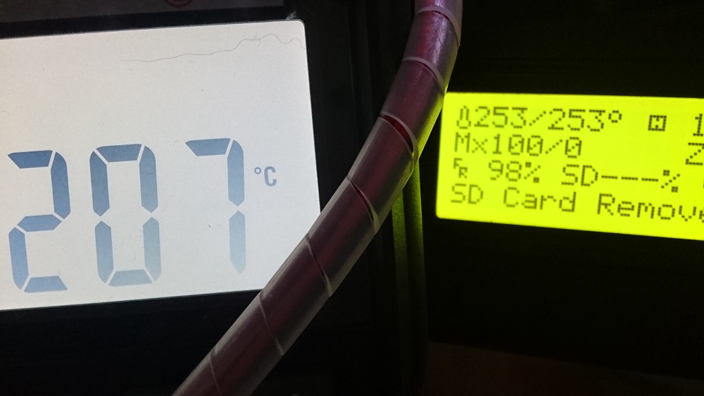

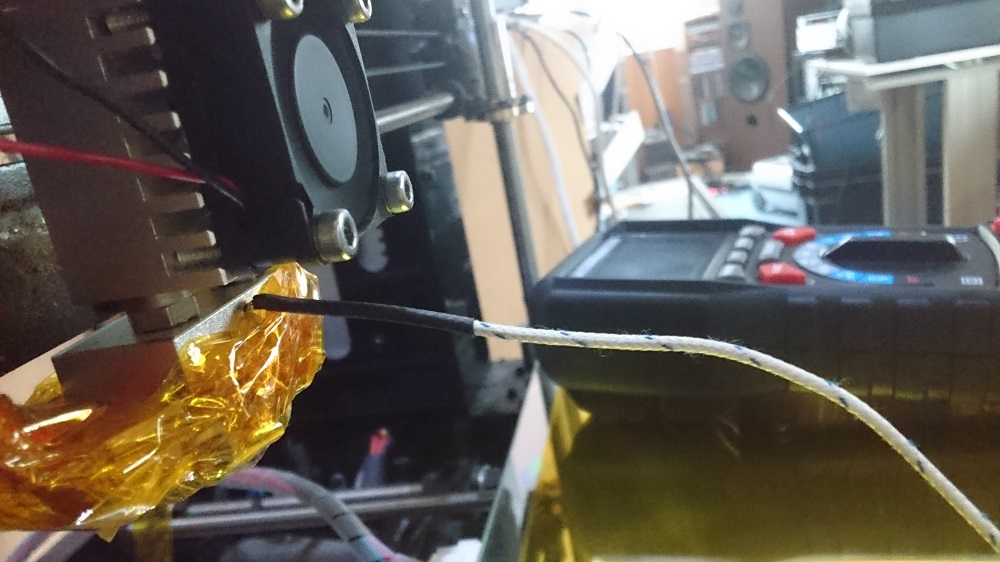

Also there is picture of my test situation and tool.
(pic.5 and pic. 6)

Hi

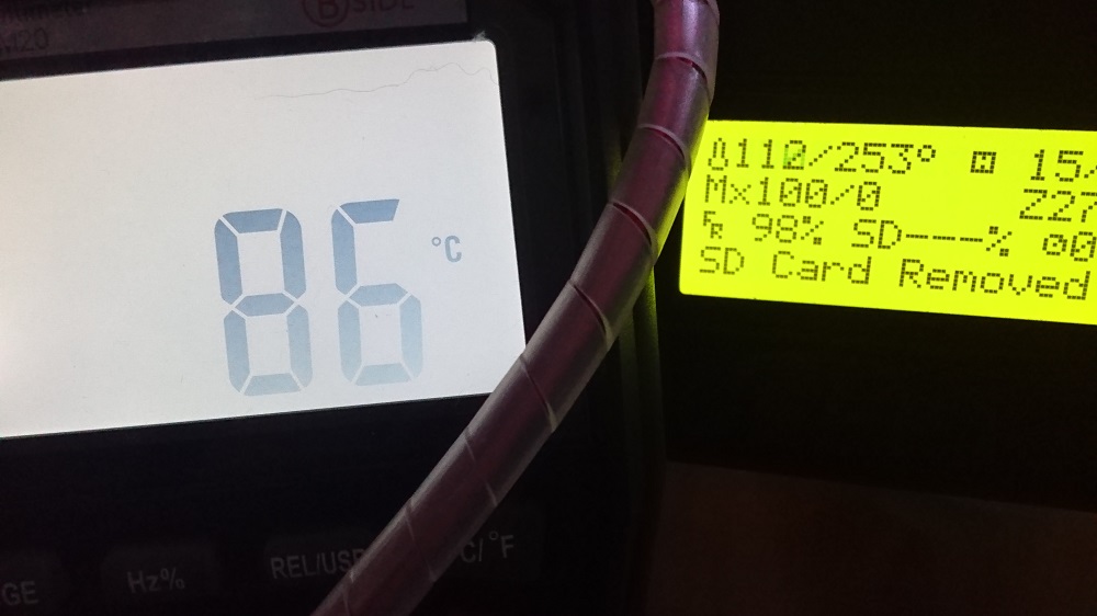

Concerning the first issue,i think maybe there is some deviation on your measurement.'Cos what you test is the external temp of the hotend while the temp on the LCD is the internal temp of the hotend.So that's it.
To verify if it reaches the desired temperature,i think you can extrude the filament with you hand to see if the flow is smooth when temp reaches.
As for the second one,i can't get what exactly you are expressing?Normally,the Z axis will move up and down to several milimeters when "auto home"?Of the printer head will auto home before printing.

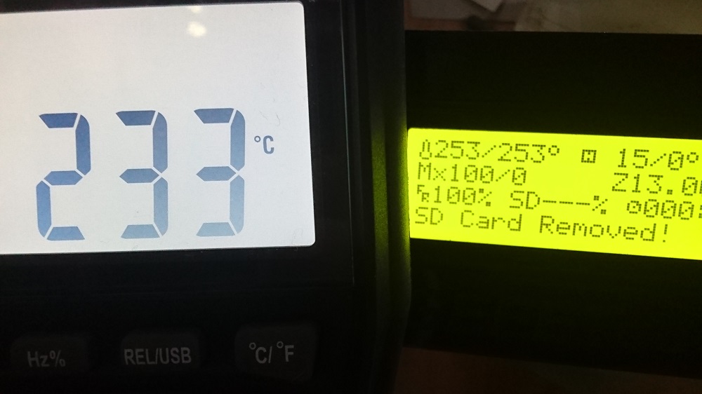

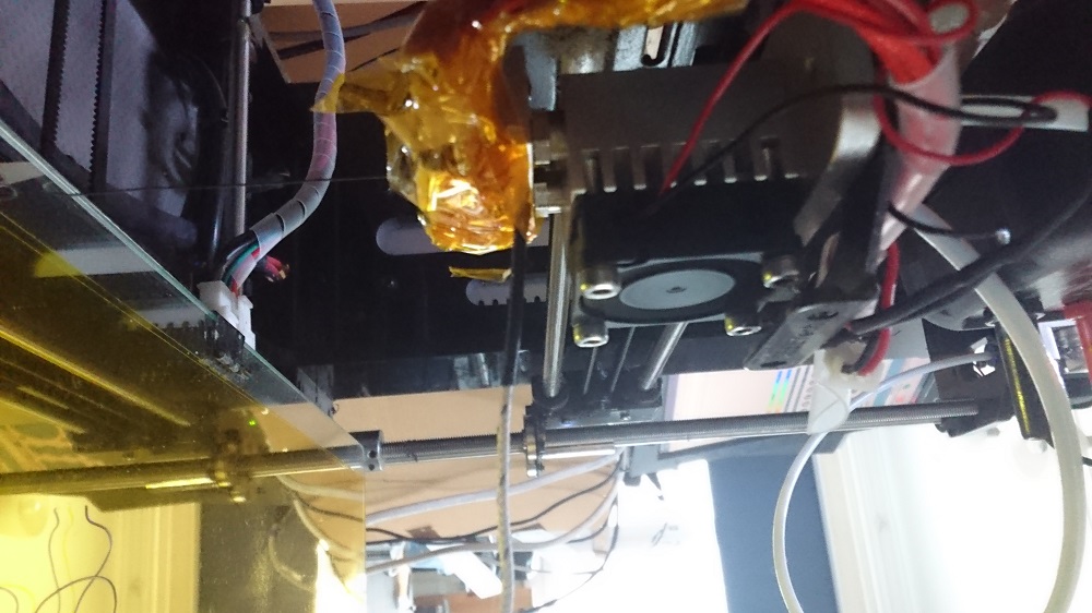

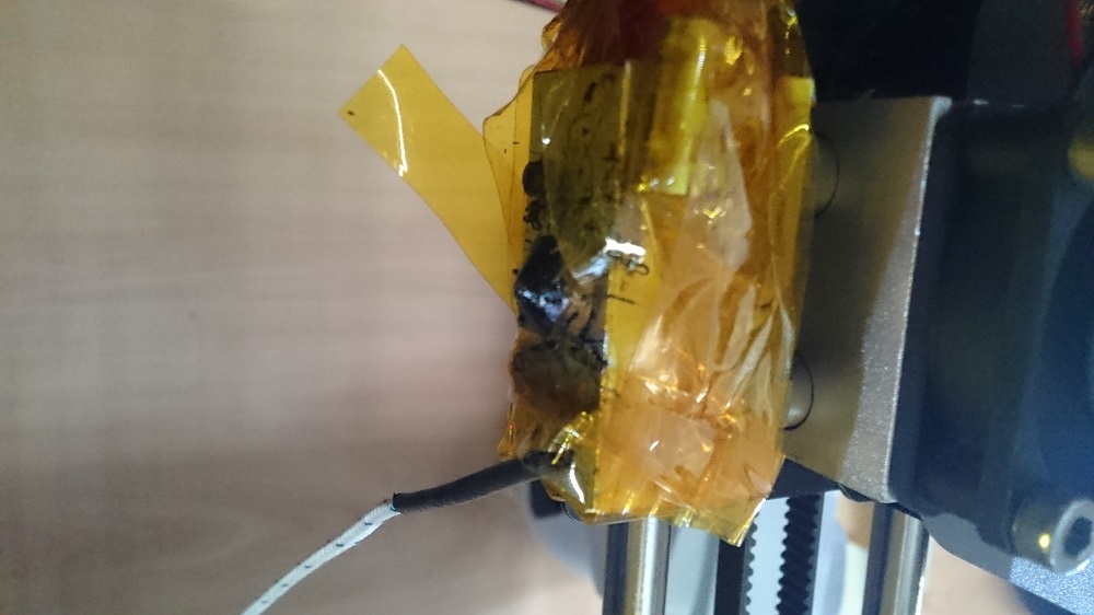

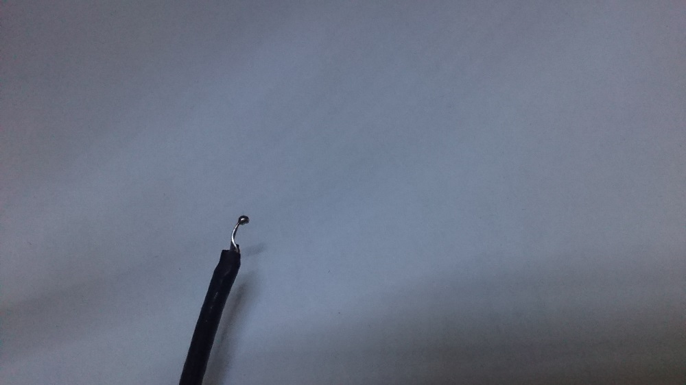

1. problem
Now I do new measurement´s and find out LCD shown temperature is 20°C more than measured. pic 2 1/2
This measurement procedure start in that few of my ABS filamen´t causes clogging in extruder. Even I heated hotend to max. temp 270°C .(limited is
not bad at all but it causes problem in this case)
Now we see that real temperature is 20C below and highest temp what i get in M201 and GTM32 with firmware 1.0.5 is only 250°C pic1 .
I need for ABS to rise limited temp +15°C up to get adjustment for hotend real temperature.between 230C - 265°C

1. problem

hey guy,you can measure the resistor by the multimeter.
Re: Major problem in M201
Off course I can measure it by multimeter using ohms not volts. But I need a curve and B=.
Real termperature°C and resistant on that temperature.-
