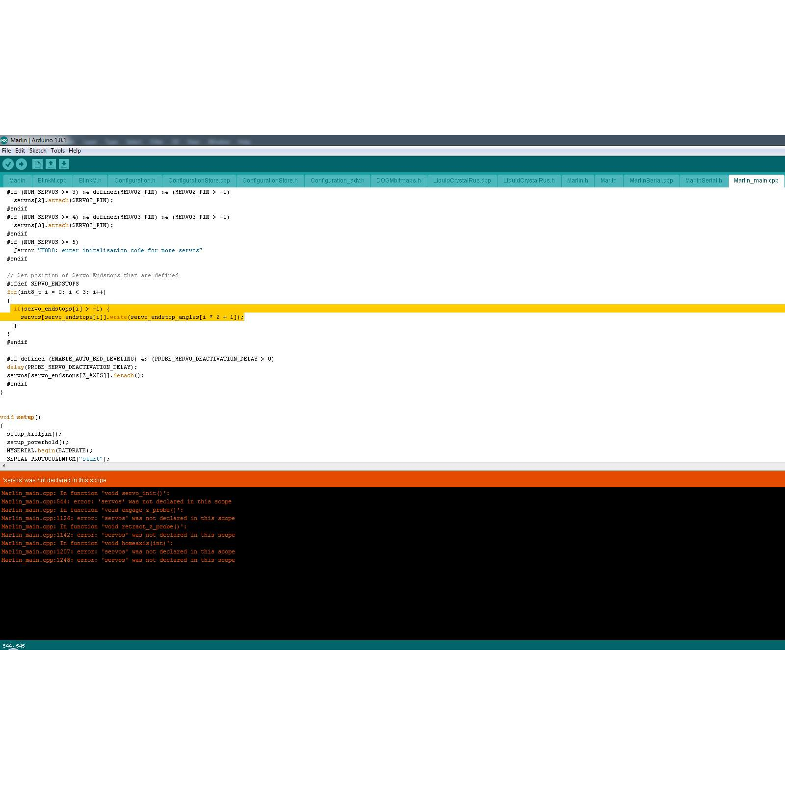

I did all parameters i saw for 3d touch to firmware but when i tried to upload to my printer i get this message
What i need to do more please
3d touch pro c upload firmware problem
- Untitled.jpg (408.4 KiB) Viewed 6319 times
Re: 3d touch pro c upload firmware problem
remove the comment by :
#define NUM_SERVOS 3 and replace the 3 with 1 like this:
#define NUM_SERVOS 1
regards
Andy
regards
Andy
thx i fix
it i didn't erase the //
