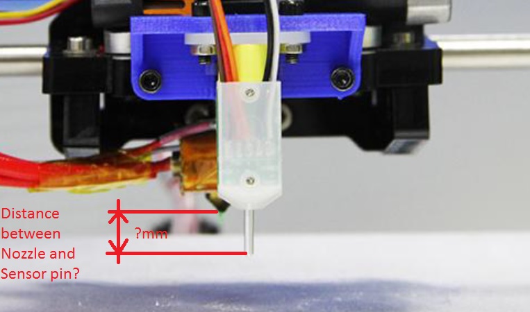

Hello everybody,
Which distance should I have between the nozzle and leveling sensor?
Because I can have another nozzle as originall.
Please help me

Post by cosmith »
You need 8.3mm between the bottom of the sensor (not the pin) and the tip of the extruder.

Hi, thank you for your support!!! :D
Now I can make additional fan in a place, where original should be touch sensor.
The distance between the bottom of the sensor means from the case of touch sensor to the tip of the extruder?
How can you get exactly the 8.3mm?
Thank you ;)

Yes, the bottom of the case to the tip of the nozzle. It's difficult to get exactly 8.3mm, but it needs to be close. You can adjust the Z offset a little to compensate or make some shims if your sensor is too high.
Having the sensor on the back is much better. You can get better calibration because it is closer to the nozzles. In my case it was about 20mm closer on the Y axis.
--Colin

Maybe someone know how to change the parameters to get the print central in middle?
peter1451
Posts: 11
Joined: Tue Jan 24, 2017 4:27 am
Re: Auto bed leveling sensor with fanduct
Post by peter1451 »
with my last Configuration.h file the print was not in the middle.
I made some changes in configuration file and now the print is in the middle.
Below is configuration.h file from Marlin:

//  - "3-point" mode
//    Probe 3 arbitrary points on the bed (that aren't colinear)
//    You must specify the X & Y coordinates of all 3 points
  #define AUTO_BED_LEVELING_GRID
  // with AUTO_BED_LEVELING_GRID, the bed is sampled in a
  // AUTO_BED_LEVELING_GRID_POINTSxAUTO_BED_LEVELING_GRID_POINTS grid
  // and least squares solution is calculated
  // Note: this feature occupies 10'206 byte
  #ifdef AUTO_BED_LEVELING_GRID
    // set the rectangle in which to probe
    #define LEFT_PROBE_BED_POSITION 0
    #define RIGHT_PROBE_BED_POSITION 180
    #define BACK_PROBE_BED_POSITION 150
    #define FRONT_PROBE_BED_POSITION 0
     // set the number of grid points per dimension
     // I wouldn't see a reason to go above 3 (=9 probing points on the bed)
    #define AUTO_BED_LEVELING_GRID_POINTS 2
  #else  // not AUTO_BED_LEVELING_GRID
    // with no grid, just probe 3 arbitrary points.  A simple cross-product
    // is used to esimate the plane of the print bed
      #define ABL_PROBE_PT_1_X 15
      #define ABL_PROBE_PT_1_Y 180
      #define ABL_PROBE_PT_2_X 15
      #define ABL_PROBE_PT_2_Y 20
      #define ABL_PROBE_PT_3_X 170
      #define ABL_PROBE_PT_3_Y 20
  #endif // AUTO_BED_LEVELING_GRID
  // these are the offsets to the probe relative to the extruder tip (Hotend - Probe)
  // X and Y offsets must be integers
  #define X_PROBE_OFFSET_FROM_EXTRUDER -10
  #define Y_PROBE_OFFSET_FROM_EXTRUDER -10
  #define Z_PROBE_OFFSET_FROM_EXTRUDER -1.4
  #define Z_RAISE_BEFORE_HOMING 4       // (in mm) Raise Z before homing (G28) for Probe Clearance.
                                        // Be sure you have this distance over your Z_MAX_POS in case
  #define XY_TRAVEL_SPEED 3000         // X and Y axis travel speed between probes, in mm/min
  #define Z_RAISE_BEFORE_PROBING 15    //How much the extruder will be raised before traveling to the first probing point.
  #define Z_RAISE_BETWEEN_PROBINGS 10  //How much the extruder will be raised when traveling from between next probing points

3D Touch sensor should measure following:
1. Centre point of the bed.
2. Left front corner
3. Right front corner
4. Right rear corner
5. Left rear corner.
The measure of points: 2,3,4,5 is ok, but for 1st point the sensor is shifted back in y axis.
Maybe someone know why?
