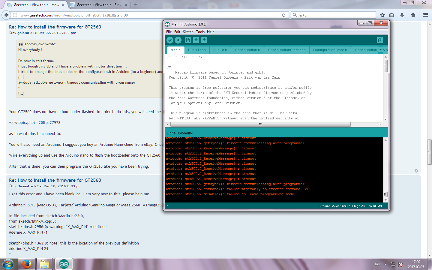

Hello,
I bought a geeetech i3 pro b acrylic printer, I assembled it and tried to connect it to PC and failed. I did what user manual told to, but no luck. I tried to reflash firmware but no lock too. Arduino 1.0.1 throws me many errors after waiting for about 10 minutes. Can anyone help me?

Re: How to install the firmware for GT2560
