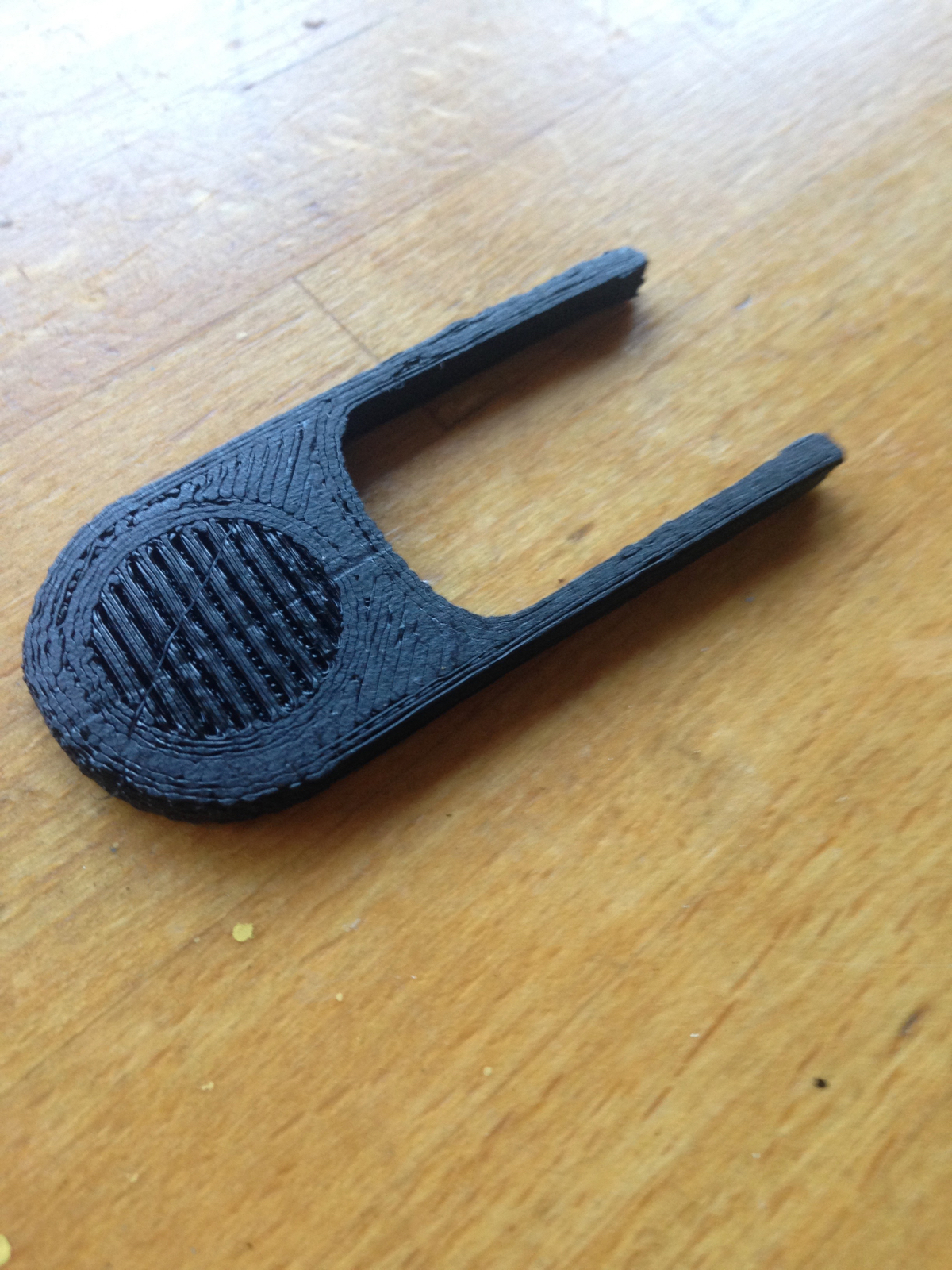

I have adjust the voltage of the drivers to 1 volt and I have noticed a little improve but the cracks of the pulleys still are there. I'm sending a new video trying to print PSU case.
At least now I can print little pieces without problems but the quality is quite poor. See the attached photo.
