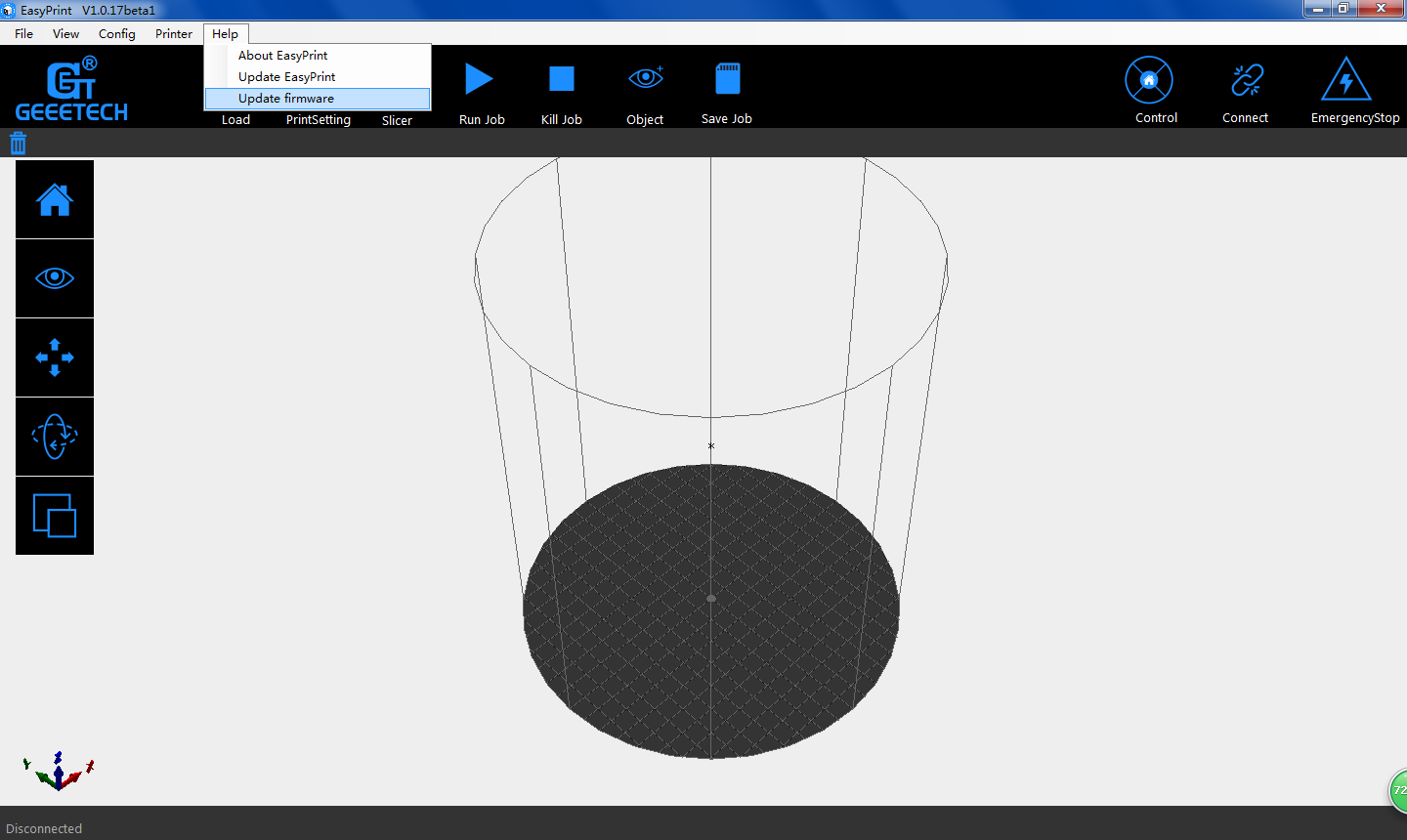

1、I suggest you to upload the firmware with EasyPrint software which you can download in this link:http://www.geeetech.com/specialpage/software/.Check the attachment.
