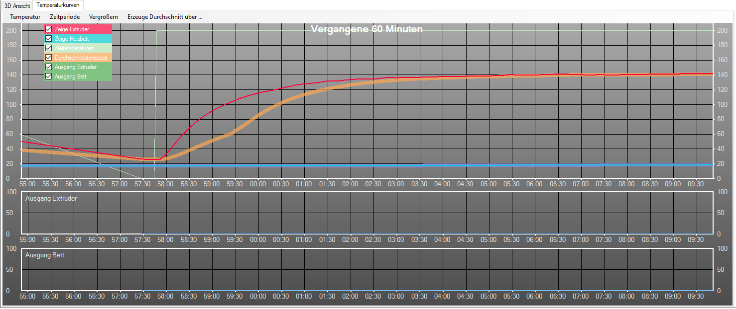

I setup all cables and want to start a testprint but with this new setup i have problems with the heating of my extruder.
so i setup the destination temperature of 200° and the printer stops before 140°... I have a screenshot appended where you can see the result with the max temp of 200°.
What is the problem? Did i need a special firmware or settings for the Rev a+ Board? Or what can it be?

- 2017-04-22 17_09_53-Repetier-Host V1.6.2.png (48.14 KiB) Viewed 12088 times

Hi,I think the Heating rods of extruder might be poor contact inside.You can refer to this post:http://www.geeetech.com/forum/viewtopic ... 19&t=17039.

11.7V at the terminal block of the board could be the issue (could be). Not getting past 140C does seem odd.
The power supply that are included with these printers have a voltage adjustment inside the power supply. I cranked mine up to about 13.2V to improve the hotbed heating times, mine took 'forever' to heat to 90C and after the adjustment the bed gets to 90C in less than 5 minutes. You have to open the power supply and there is a small trim pot near the terminal block of the power supply. Put a DVM on the 12V output and adjust up and see if your print head gets past 140C. If it doesn't then there are other issues. Look to see the thermistor is solidly attached to the head.
