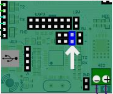

Hi,when you pull out the jumper cap in the position of picture,the MCU will be changed into Mode DFU.

Doesnt work on my board. wheb you put the cap on those pins rx/tx lights go off. Wheb you remove the cap both come back on. windows can not reconize it.
