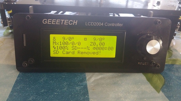

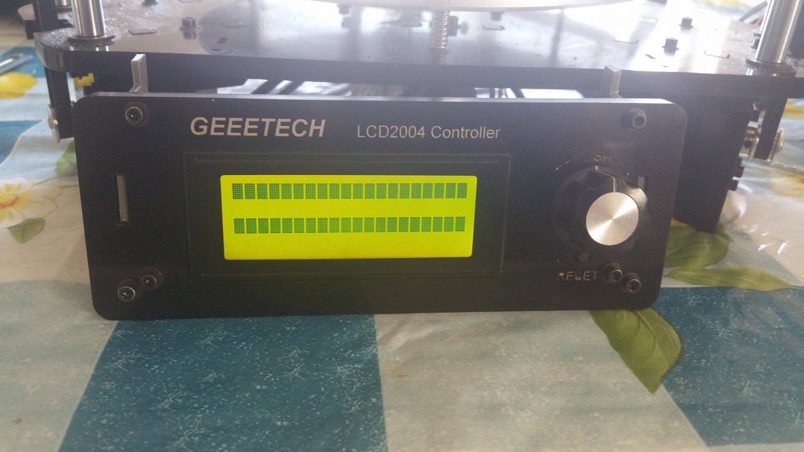

A update ..... Yes the card formatted to Fat32, I again tried insert the card with no reading, then leaving the card inserted turning off and on the printer, the LCD screen then went to 3 lines of blocks across the whole screen, once I removed the SD card the LCD screen return to normal??
- This is after I insert SD card or with No SD Card
- withoutsd.jpg (100.19 KiB) Viewed 15956 times
- This is with SD Card insert then turning power off and back on again
- 18318423_1418127681577302_1380663014_o.jpg (417.99 KiB) Viewed 15957 times

I went out and bought a brand new SD Card which was smaller in size, then formatted it to Fat32 and put the GCode into the Root Directory
Now the LCD Panel is reading the new SD Code.... I am not using the Bigger SD Cards any more
Issue Resolved
Issue Resolved
