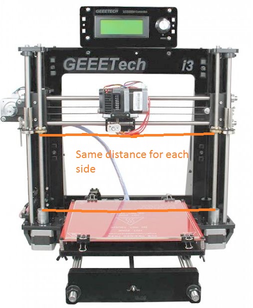

Recently installed a 3d touch followed all instructions on this page.
Finally got it all working.
But....
When i send a print it goes and checks bed level in 16 spots like its ment to, then it prints.
When it prints, it prints on an uneven bed, there is the right amount of plastic on one side of bed and very little on the other side.
I know i could level my bed but thats the whole point of this sensor.
Any ideas ?
Rv8
Posts: 65
Joined: Thu Mar 09, 2017 1:26 am
Re: Latest Marlin RCBugFix branch for PI3 Pro B
Post by Rv8 »
Hello,
the first thing you could do is to use a bubble level for a good bed settings.
after you could check if the space between each Z axis motor and the couplers are the same.you can use a caliper and manually move the engine when the printer is power off !
Maybe you already do that ? I don't know.
After I already that the same problem, and yesterday the problem is gone, because I change the nozzle with a new one on my prusa I3 pro B.
The new nozzle is better quality, i bought 5 nozzle of 0.3mm for 1.75 wire at 9.90€
Othersise you need to set the offset but this part is strange because i notice that the real offset for me is not correct so I try each step and I found the correct settings, for me it's M851 Z-1.0
I hope this could help you.
