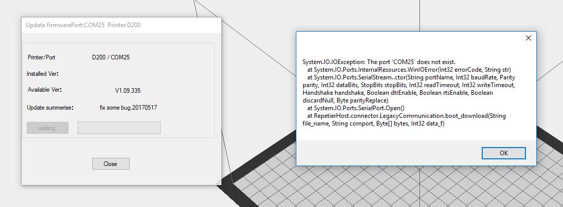

When I selected to update the firmware ... I just got the box shown below ... I've never seen "D200 / COM25"
I'm just stopped there ... I'm running Windows 10

The COM port and printer should be selected correctly before you upgrade the firmware.According to the picture you have sent above,It's wrong. Please double check the instructional video which are a series.

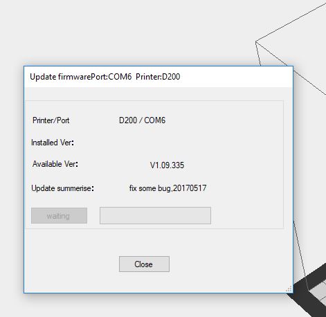

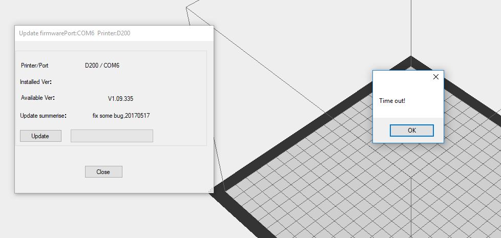

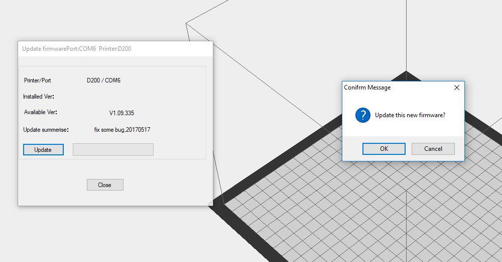

a) The Update Firmware box opens up, I click 'update', then click OK in the confirm message box ...
b) Then is seems to start working ... but with the 'waiting' showing ...
c) About 30 seconds later ... the 'Time Out' box shows ... I click OK ... then start the cycle again with clicking 'update' on the original box, the OK again on the message box
My computer seems to freeze up after ... and have to restart ...

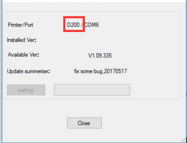

After watching the pictures,you sure the printer are correct?D200?
Re: New Sanguinololu board _ Major Z axis moving problem
No ... I'm not sure at all ... that was the one shown on the video as well default setting that was on the software ...
I have the Geeetech Aluminum Prusa I3 3D Printer kit ... probably the same number from the beginning of the year ... 800-001-0370
Could you let me know which one I should be using ... and I'll retry the upgrade using that setting ...
