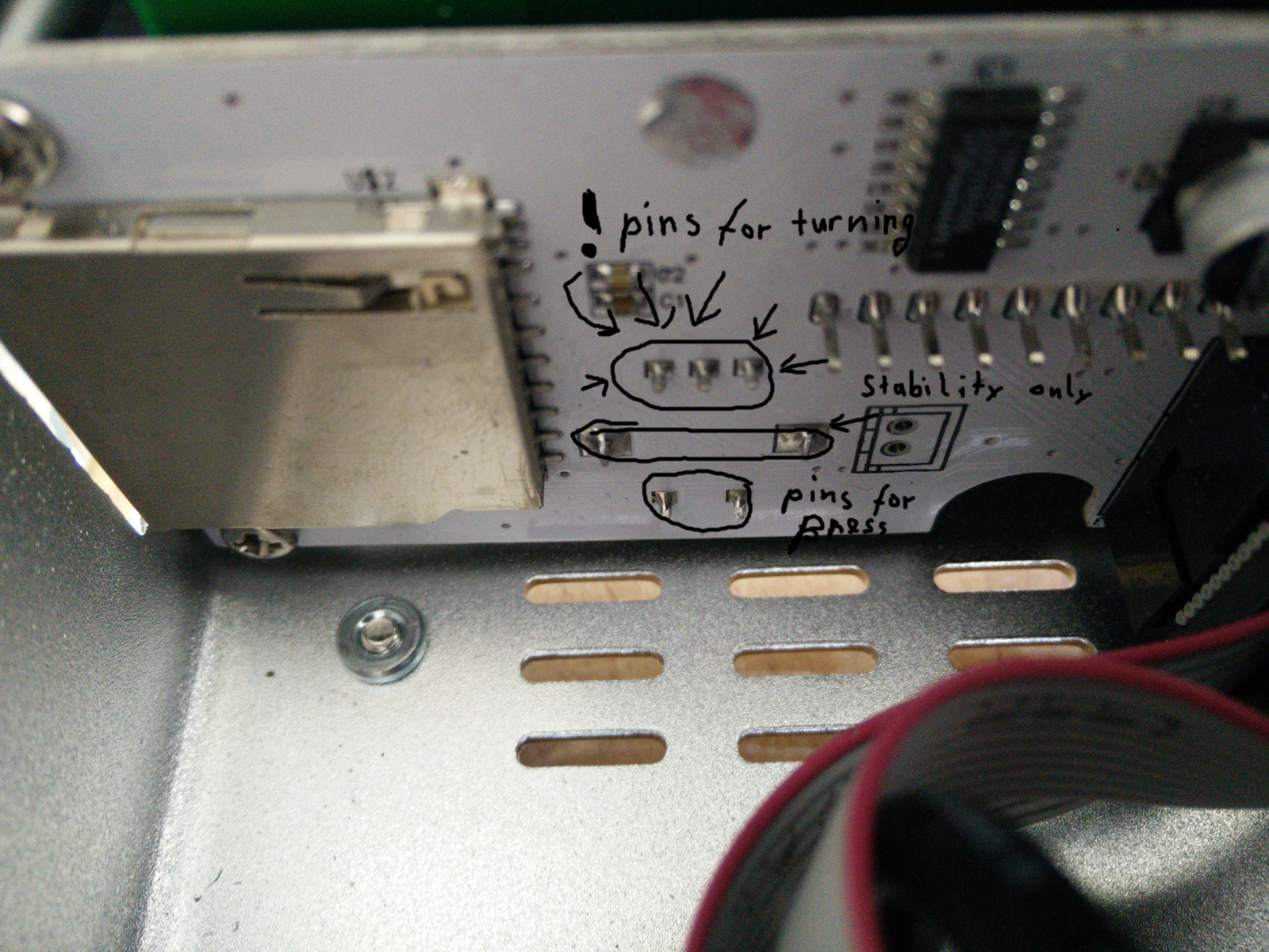

1) First try to locate the contacts directely at the turning knob. On my board this are 7 solder joints: (see picture "knob.png" for reference)
There are two big ones which are relatively far apart from each other.
Those are only for holding the knob in place.
Two solder joints are next to each other and my multimeter says high resistance when the knob is not pressed
and low resistance (beep in diode mode) when the knob is pressed. Because pressing the knob works for you this is
not interesting for us...
The turning knob has 3 solder joints in row, those are to let the microcontroller know in which direction the knob was turned.
If you turn the knob by one step for me all three joints have zero resistance. If you turn the nob one step further then there is no connection between the pins.
You can ferfy that the connection is open with a multimeter in diode/beep mode.
2) Now turn the knob in a position so that there is no contact between the three pins. Test that with a multimeter.

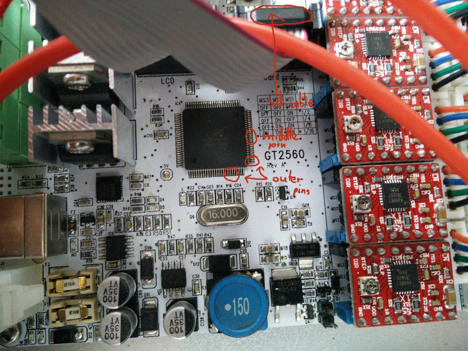

3) See picture "connections_knob_board.jpg":
Put one test lead of the multimeter (in diode / beep mode) to middle pin of the three pins which handle rotation detection.
Turn your gt2560 board so that you can read the "GT2560 Rev A" label aswell as the label on the atmega2560 microcontroller.
Now slide the other lead of the multimeter over set of pins on the right side of the atmega2560. Somewhere in the middle of the pin row you shoud get an beep.
Next move the lead at the knob to one of the outer pins of the "three pin row". Because I don't know in which direction the knob is placed on your lcd combo panel i can' tell you which outer pin is which.
One of the outer pins has contact with a pin on the right side of the atmega2560 at the bottom of the pin row. The other one has connection to the lower row of pins somewhere at the right of the pin row.
Do you get all three connections?
If yes then it is very likely that this is still a software / firmware problem.
If no check the cable (it should be the sd cable) if it's still good. And check the traces on the gt2560 from the socket to the atmega2560.
Basically you need to track where the connection is broken starting from the knob how far you have connection with all three pins.
(This is important for the next step because only then we can test if all the pins arrive at the microcontroller individualy!)
