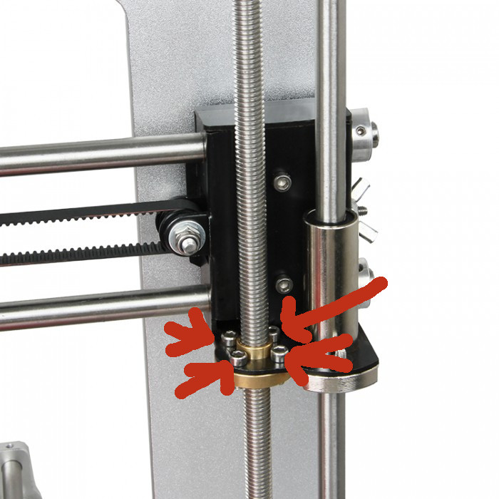

Sometimes the Z-Axis is hard to move for the motors because the x-axis is tilted slightly. This makes movement for the motors nearly impossible and should result in a strange noise. Can you try to turn the threaded rod of the z axis by hand and get both sides of the x-axis roughly at the same level (just test if the motor can move relatively easy). Sometimes it helps to losen the four screws at the end of the x-Axis just a bit because if the "golden/brass" part is tilted it's hard for the motor to move the axis (I don't know how I should call this part so I attached a picture). You can also try adding some grease/lubricant on the threaded rod.
