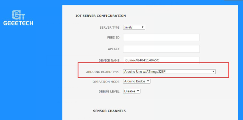

Reset Iduino Yun Shield. Please use the latest version of Arduino IDE. Choose correct board type . Try the board type:"Arduino Uno w/ATmega328p".

Thanks, but Yes I did all of that.
