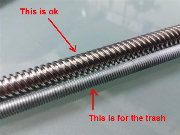

Two threaded guides of m8 for the blessed z axis the threaded rods that come with the machine have gone to the trash are twisted and the machine does not work well. Simple as that. I will attach a photo so that I can see the manufacturer which are the ones to put, if I know that they are somewhat more expensive but without that well balanced is a disaster.
For the one who starts to mount one that does not bother to install the rods that he brings directly to the trash and buy suitable ortras, they cost about 25 euros but you will remove headaches and lost hours.

Dos guias roscadas de m8 para la dichosa z axis las varillas roscadas que vienen con la maquina han ido a la basura estan torcidas y la maquina no funciona bien. Asi de simple. adjuntare una foto para que vea el fabricante cual son las que hay que poner, si ya se que son algo mas caras pero sin eso bien equilibrado es un desastre.
Para el que empieza a montar una que no se moleste en instalar las varillas que trae directamente a la basura y comprar ortras adecuadas,cuestan unos 25 euros pero os quitarais dolores de cabeza y horas perdidas.

- differences?

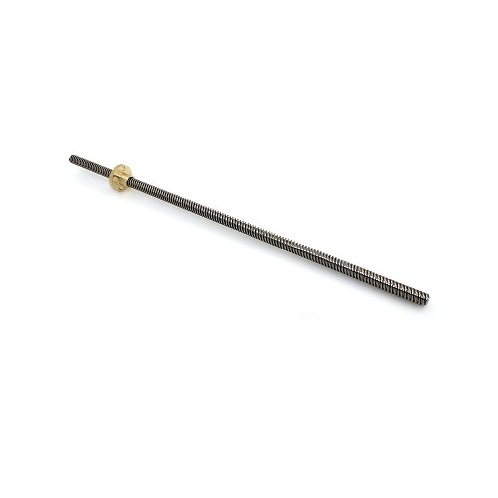

- bar.JPG (31.14 KiB) Viewed 10615 times
- This is not the one that the printer brings.Are there
- 41NTAMbDuIL._SL1000_.jpg (30.07 KiB) Viewed 10616 times

It's finished.
By changing the rods the z axis works perfect.
Those that came with the machine are in the trash.

The threaded rods were and have been replaced by those that can be seen in the photo.
The reason is very simple, the ones that come from the factory are crooked, but not only those of my printer, all those that send to everybody if they are like those are the same. They are not perfectly straight and shaft is not working properly.
That type of threaded rod is not made to handle an axial axis.
This is so, I know it and you too, do not admit it.
