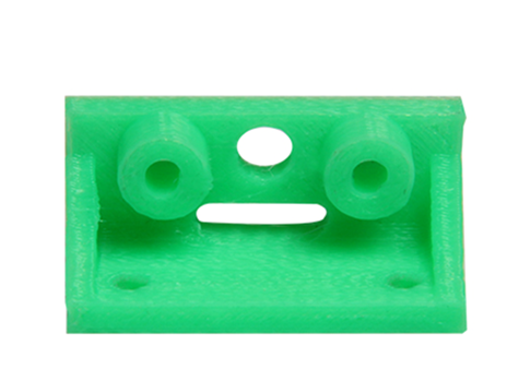

Do you screw the axis tightly? and do you add the sensor to printer by this fixture seeing on the picture.
