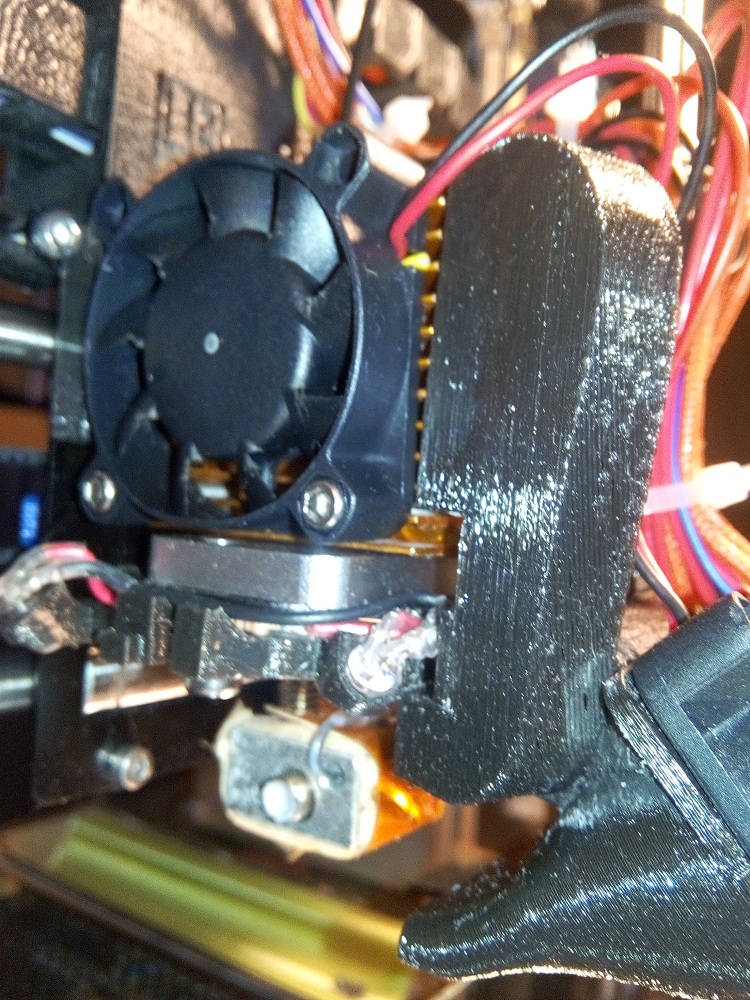

I’ve do some test and my idea that the barrel are not cooled enough was confirmed!
I’ve design a specific update to my customization in order to redirect the MK8 fan air versus the barrel, so versus the cooling zone:
Mono Extruder In Place B.jpg (410.26 KiB) Viewed 31399 times
With this I finally am able to print “strange” PLA that ask more degrees, with retraction!
You can find on my http://www.thingiverse.com/thing:1708971 like all other componets of my customization!
