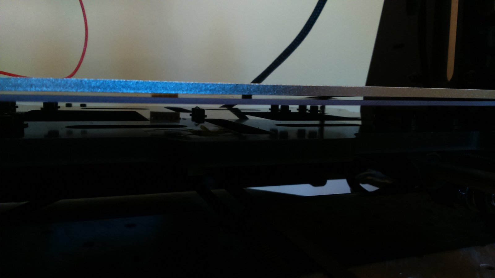

Three views:

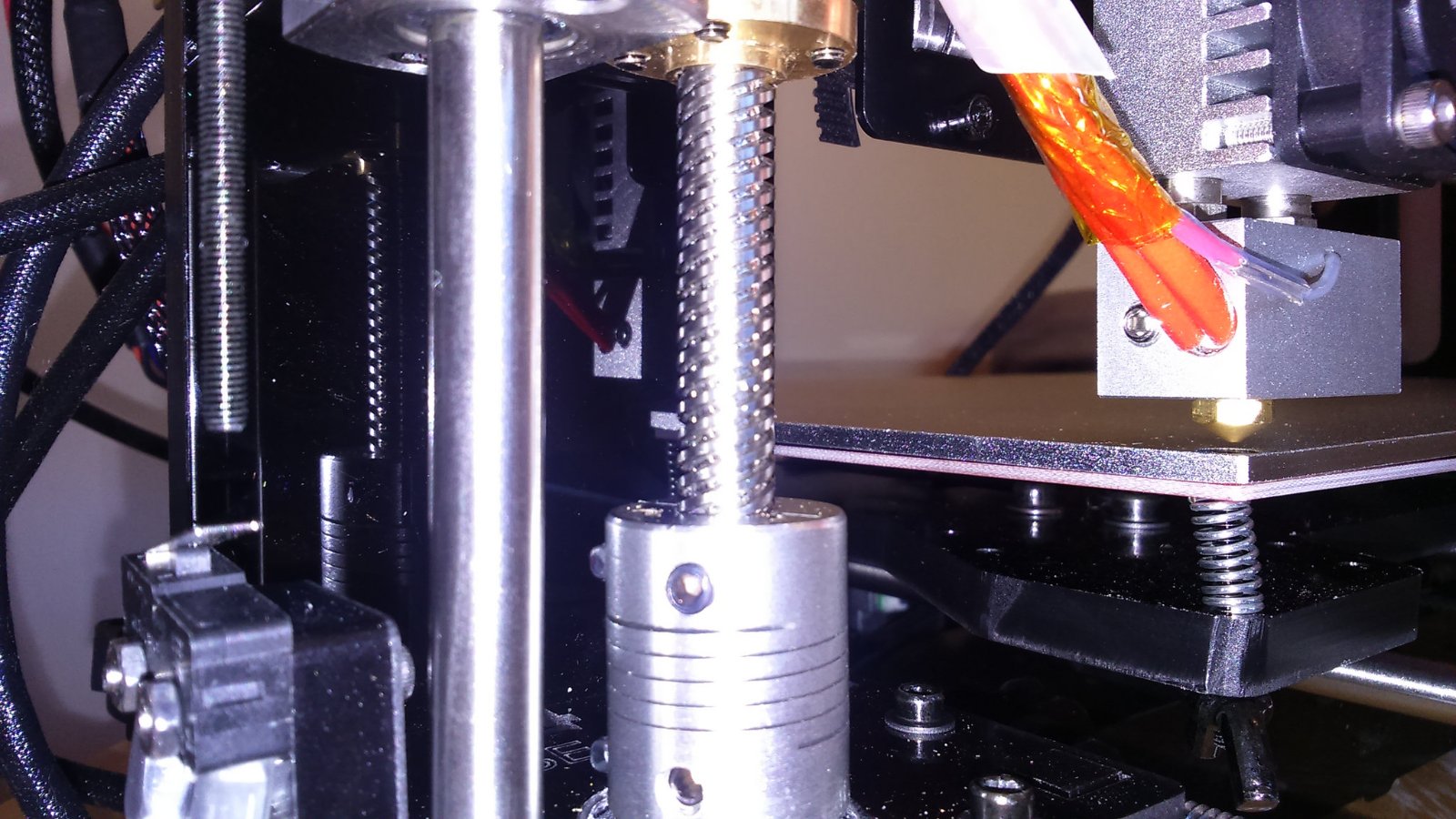

This shows the gap at the front - you can see all the way out to the back:
Front gap
Front gap

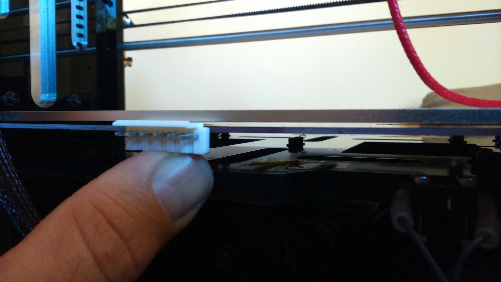

This shows the heater connector actually stopping the plate touching the heater at the back:
Connector interference and rear gap
And this shows the front left corner, where as with the other corners, there is no gap. It also shows the large (~12mm) gap to the Z-Axis home switch when the extruder is right on the bed, which also can't be quite right. I've checked and the extruder and extruder bracket are mounted as per the instructions:
Corner and home switch
