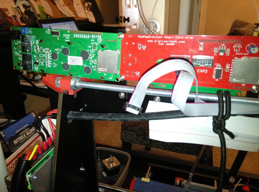

All steppers work and can be operated via Repetier-Host manual. I really believe the issue is with the LCD/SD Reader.. I've tried both (attached)

Cancel my question. The problem is that the ribbon cables have to be reverse from the original position by shaving down the guides.
