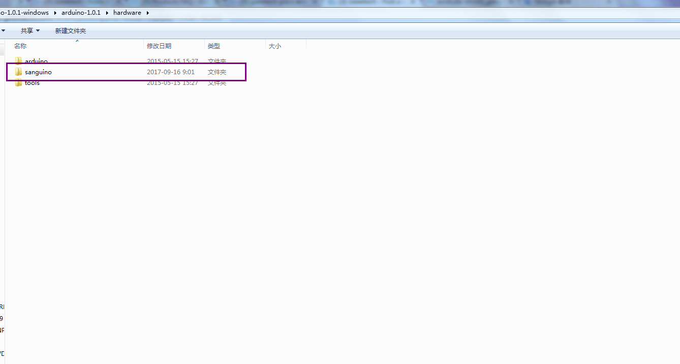

Re: Uploading firmware problem on the Aluminum Prusa i3
I have a new idea about it. I think we should use a right hardware of sanguino in Arduino IDE 1.0.1.
I attach the sanguino.zip and put the folder named sanguino below the folder named hardware.
Then re-open Arduino IDE 1.0.1 and choose the right board: Sanguino W/ATmega 1284p 16mhz
